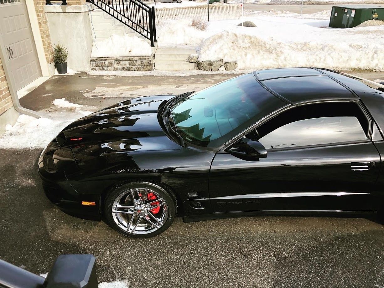

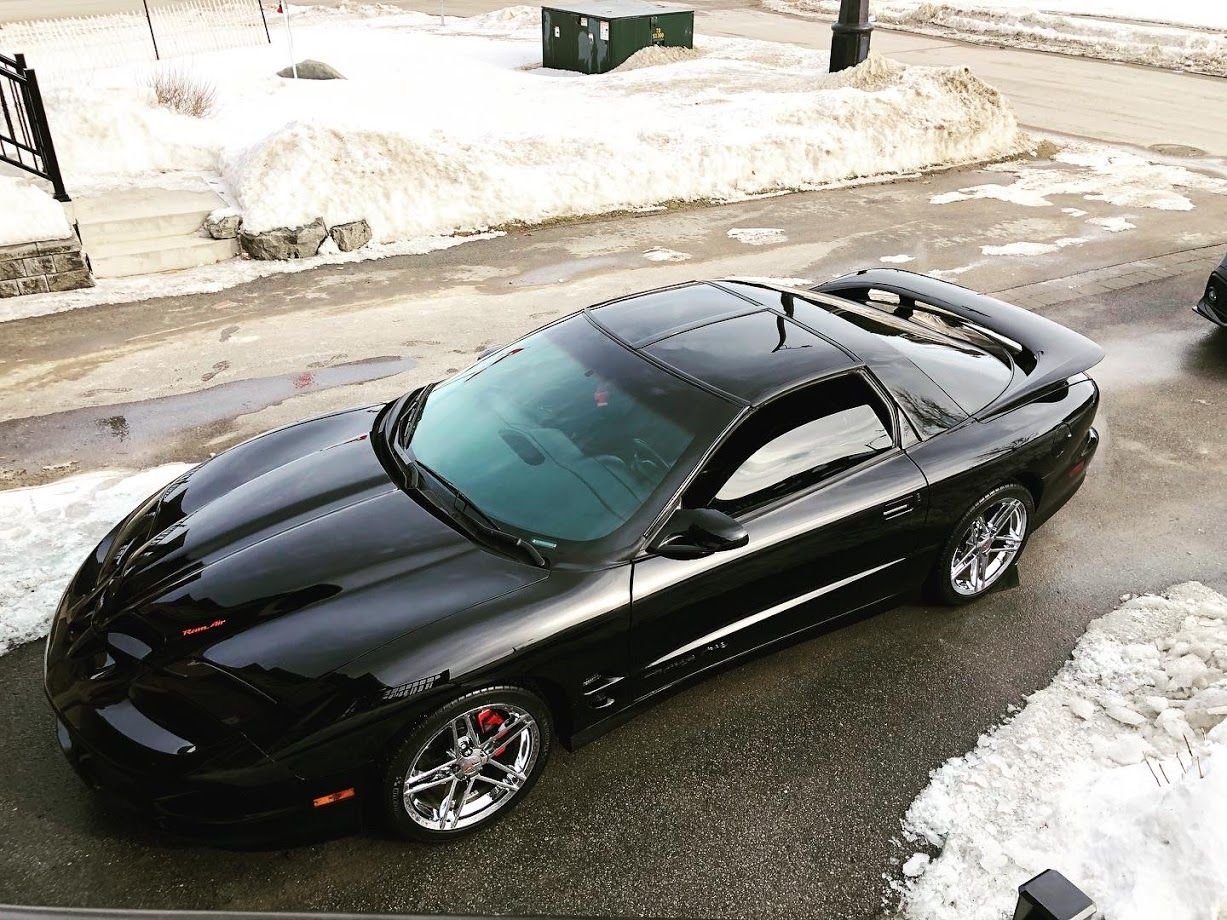

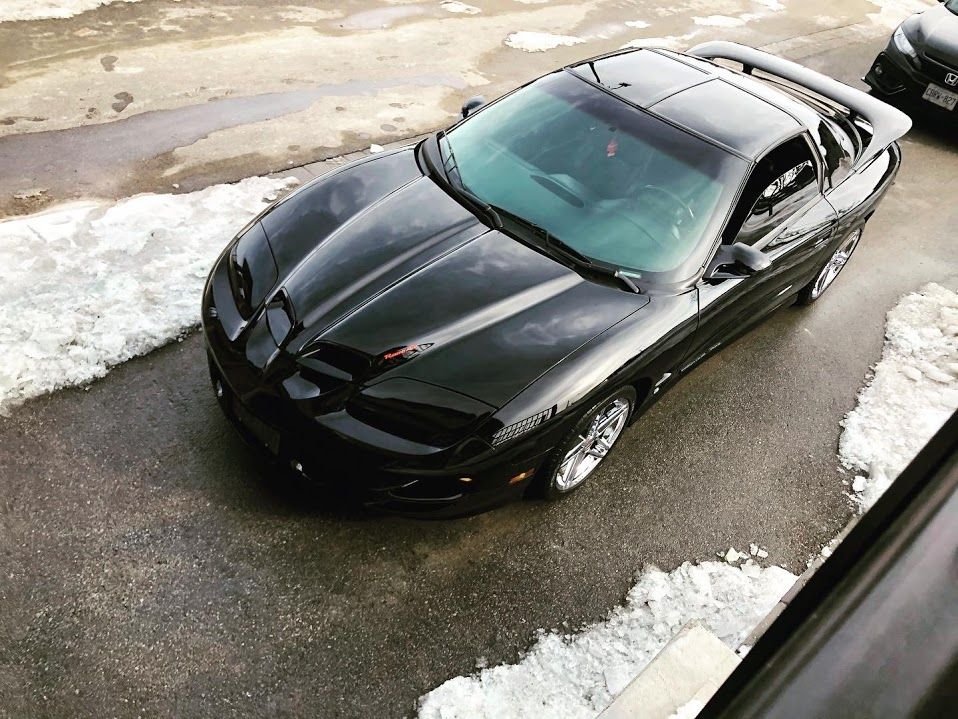

Aside from the full 8 hour day I spent doing this it cost me ~$340 which would be a lot less if I already had the buffer and "hard" supplies. I'm super happy with how the car turned out and once I get the new wheels for it it'll be mostly sorted out. I've seen mixed reviews on the Avalonking coating, so I'll try to update this after a year if I can remember to. Here are some pictures because why not:
After the buff:
After the ceramic coating:
