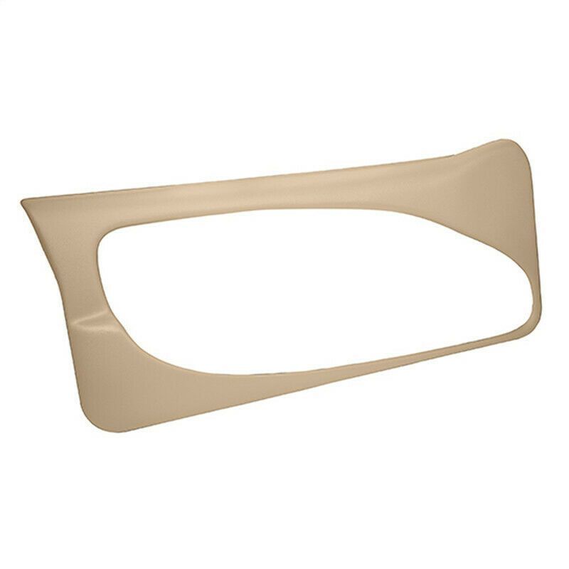

Default Coverlay Door Panel Insert
Hello. And greetings from Norway. :-)
Anyone got this?
How does it fit and look?

I found out more today about this coverlay. I decided to order a pair.
Details: They are sold in pairs, the brand is called Coverlay. The part number is 18-72-BLK (replace BLK with your color if not black). The panels are glued, similar to the dash caps for the 2nd gen Firebirds and other 70's dashboards. It is ABS plastic and said to fit perfectly. I am looking at my door panel and I see no reason why it would not work. I suspect the best place to glue the cover on is while the door panel is installed on the car. Hopefully there is enough plastic at the top that it can slide underneath the rubber window seal for a clean look. Only thing I wish they were about $100-130 for a pair, not $300, I think the price point is too high for what it is.The overlays will come with silicone adhesive and the instructions are pretty straight forward. Will see how it works, will reply when I get then.

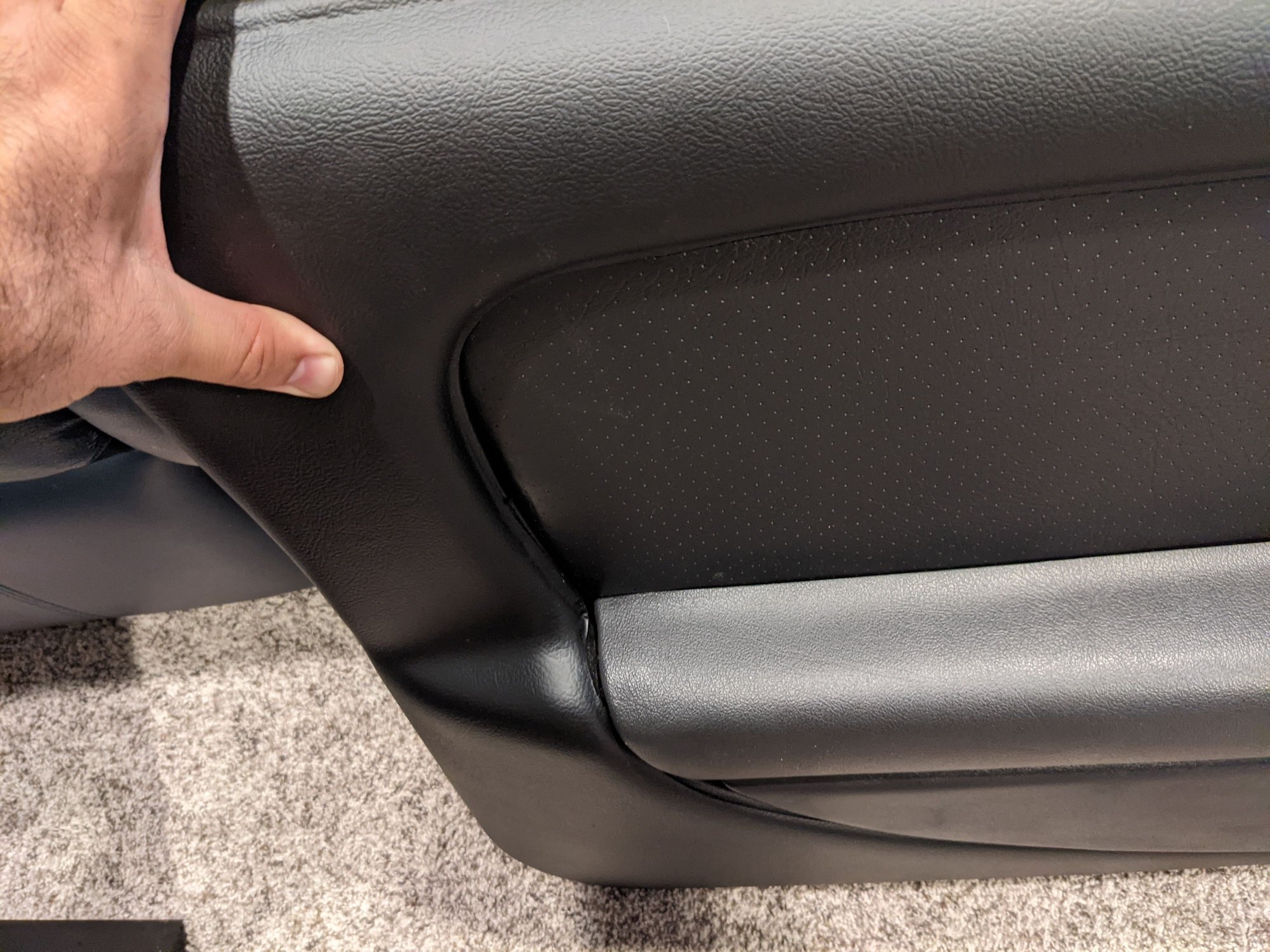

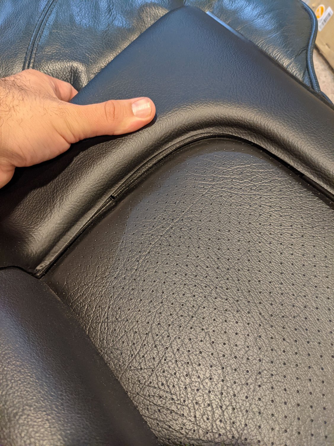

The coverlays arrived yesterday. I test fit it on my cracked door, I would give it a 6 of 10 as far as fit. Will post pics later but it leaves a lip in the inside upper area where the fabric/leather is. Also it bubbles over the rubber seal across the top, I would rather this slid underneath. Color is ok but you can see a difference.
It's not the optimal solution, if you can fix the crack stick with that.

See if these attach.

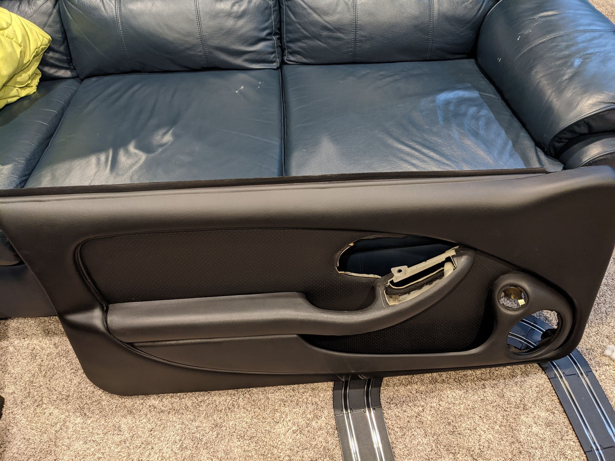

I decided to buy an earlier year door panel and paint it with SEM Landau black topped with Low Luster Clear. If you can't fix or find a replacement door, this is your next option.

Really, that doesn't look too bad. Maybe stuff some round foam insulation in the gap if it bothers you too much.
