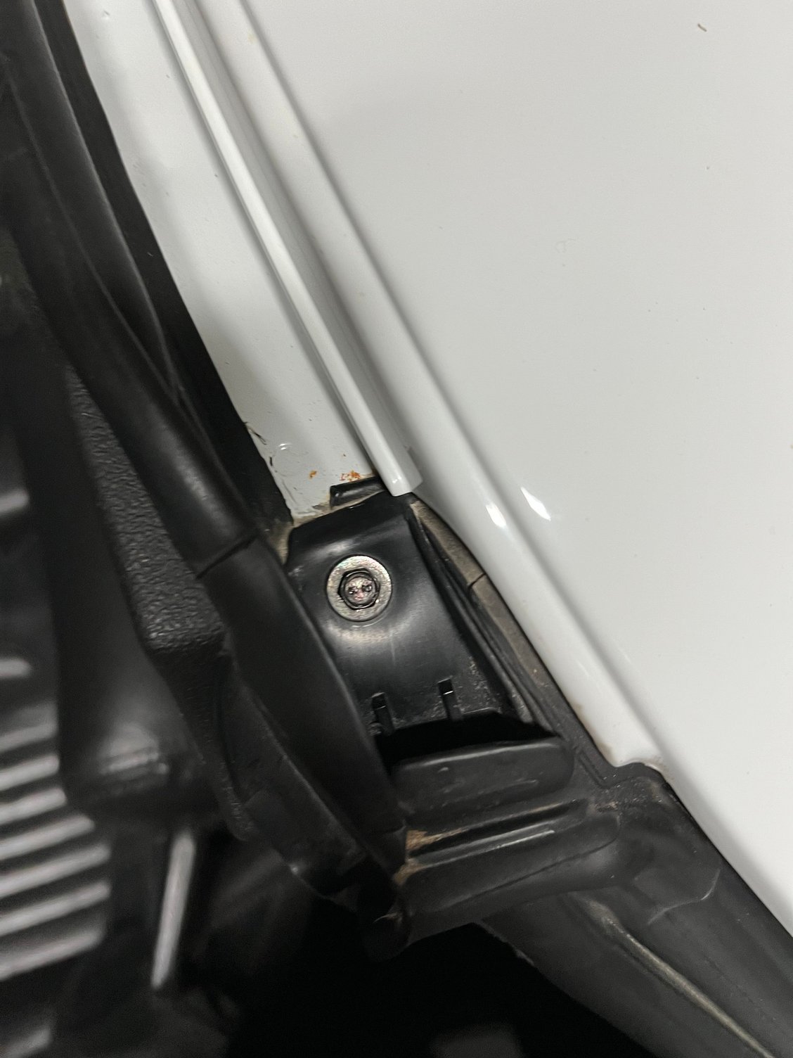

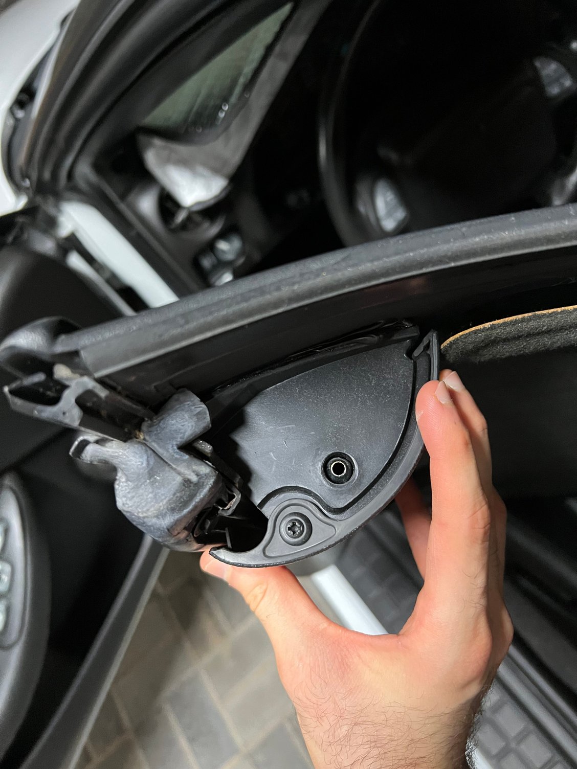

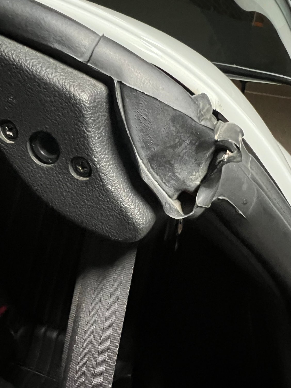

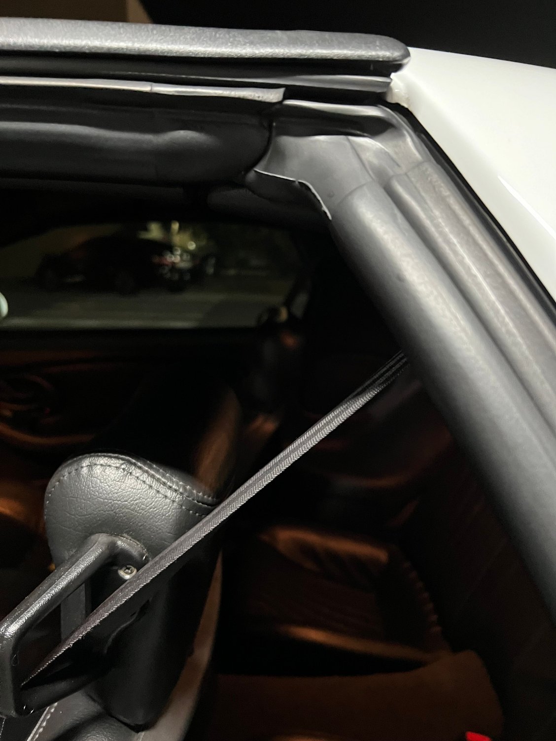

can someone please recommend the best products to do some maintenance on the rubber and weatherstripping of our cars? Mine is a 2002 WS6, and I’d like to take good care of the rubber and weatherstripping before the summer heat damages them and make them dry, I live overseas in UAE, and you wouldn’t believe the summers we have here.
I already have a very small leak from the driver’s side B pillar, but that’s to be expected with a 21 year old car. We’re talking about 2 drops on the rear driver side seat, floors and headliner are dry. please see the below current pics.
