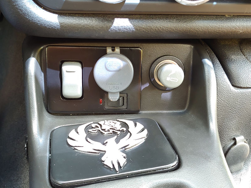

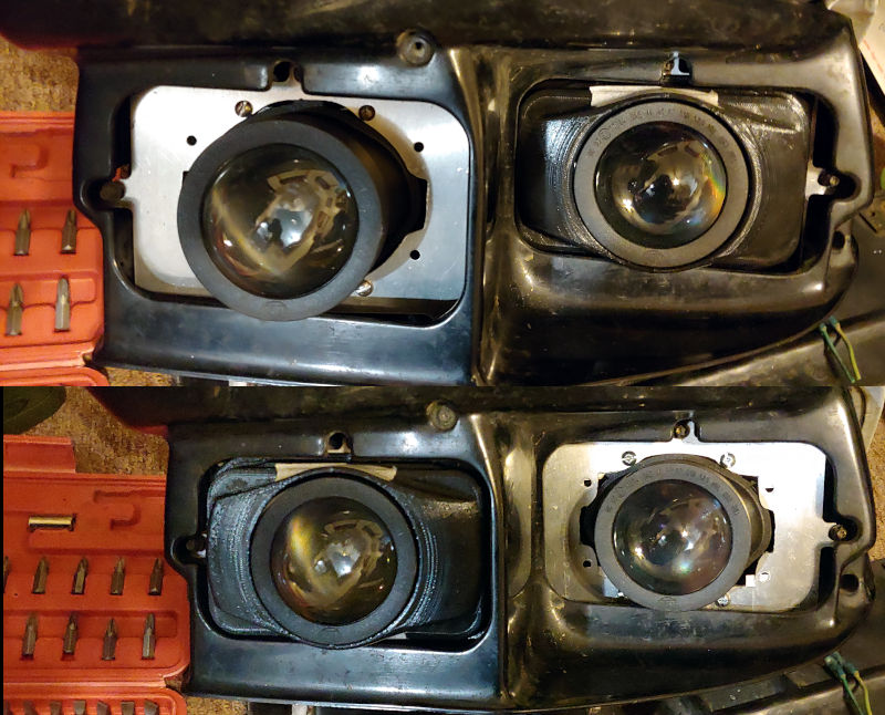

Here are some Ive made. My 3D Printer at the time could not do larger ABS pieces so some of these were printed by CraftCloud. I designed them all though.
HVAC *****
The ring is metal but the insert is custom 3D printed.
https://ls1tech.com/forums/appearanc...vac-*****.html
TCS Panel & Ashtray Cover
https://ls1tech.com/forums/appearanc...tch-panel.html
Projector Shrouds for Sinolyn Bi-Xenon Projectors
https://ls1tech.com/forums/appearanc...rojectors.html
Projector Shrouds for Hella 60mm Projectors Projectors
https://ls1tech.com/forums/appearanc...r-shrouds.html

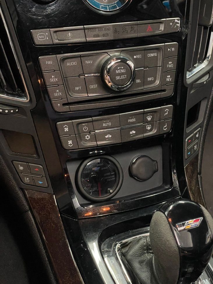

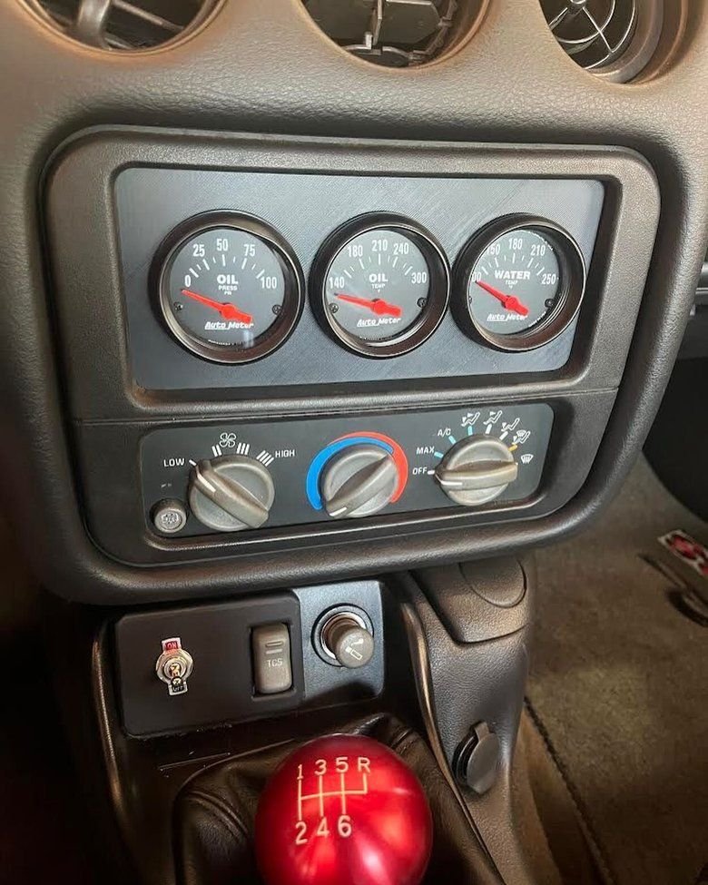

Printed a good bit of interior and exterior stuff over the years. Post them all in my build thread or my instagram if you have it @coreyprints
Typically use Polymaker ASA or CF-Nylon. I found the polymaker asa had a lot less odor than the bambu asa.
Here are just a few examples. Mostly doing gauge pods, but also have done some mirror brackets, ttop bar end caps, tweeter pods, various switch plates, etc.
