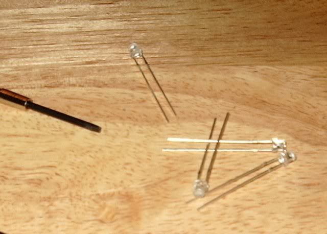

Thanks to this site I finally have 100% of my dash lighting up blue now! It was pretty easy to change them out. I did do something different than his write-up. I grinded the heads of the LEDs flat to dispurse the light more and also had them pointing at the odometer. I also changed the E-Brake LED to a blue 10K mcd LED. Even though my digital camera sucks at night pictures, all blue lights in my car matches.
Also did my TCS, Conv. Top (For QTEC) and fog light switches last week.

Thanks! I can't take credit for the odometer, if it wasn't for him I probably have never gotten around to figuring it out. When I first looked at it at dusk it looked to match, but when it's dark it's more of a bluish-puple color. It doesn't match my other lights, but I did use 3mm 7000mcd blue LEDs. At least it's not orange anymore.
The SLP mount came from www.humount.com
