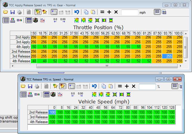

Originally Posted by nalmak
Ok..I did what you said and it is the converter..i gently applied pressure to the brakes and the vibration went completley away!!!..THANKS!!!!...Now if i tune it not to lock up in 3rd, then when do i tune it to lock up?..it has to at some point?..
4th gear
Example:

Originally Posted by CoolAid
4th gear
Example:
What am i looking at?..
