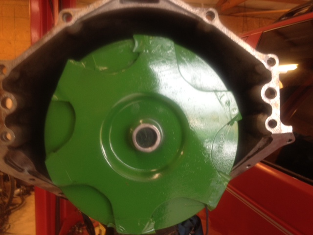

Well, I went ahead and tore the tranny all the way down and refreshed/rebuilt it. All new clutches, steels,new sep plate etc etc. Got rid of the Transgo vacuum modulator kit and put a PCS back in there. My new converter arrived this evening so I wasted no time installing it into the trans and then I put the trans in the vehicle. It is hanging uder there with a couple bolts-ran out of time. I should have time to finish it Saturday evening...will report back here on how it shifts as soon as the road test is complete!
