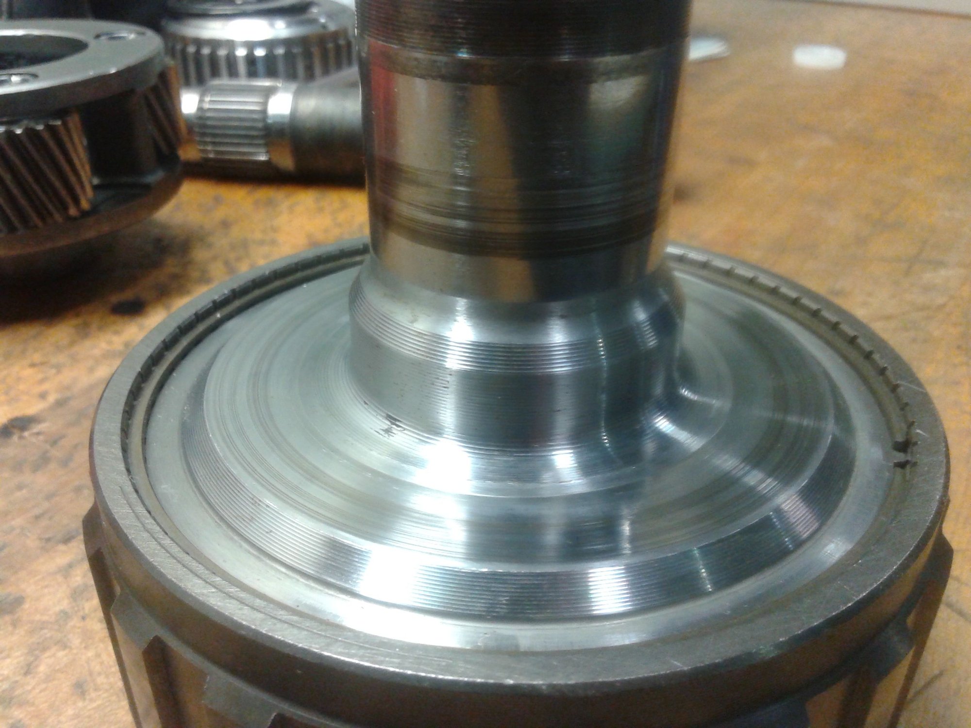

Posts: 157
It's unevenly worn just slightly i can feel it but can't catch my nail in it.

Also the sunshell that came out was a beast and also had the 4 tab brass washer. I figure that I'll replace this reaction shaft and the thrust washer and be good to go.

Couldn't source a old style reaction so I'm switching to new style with the bearing.

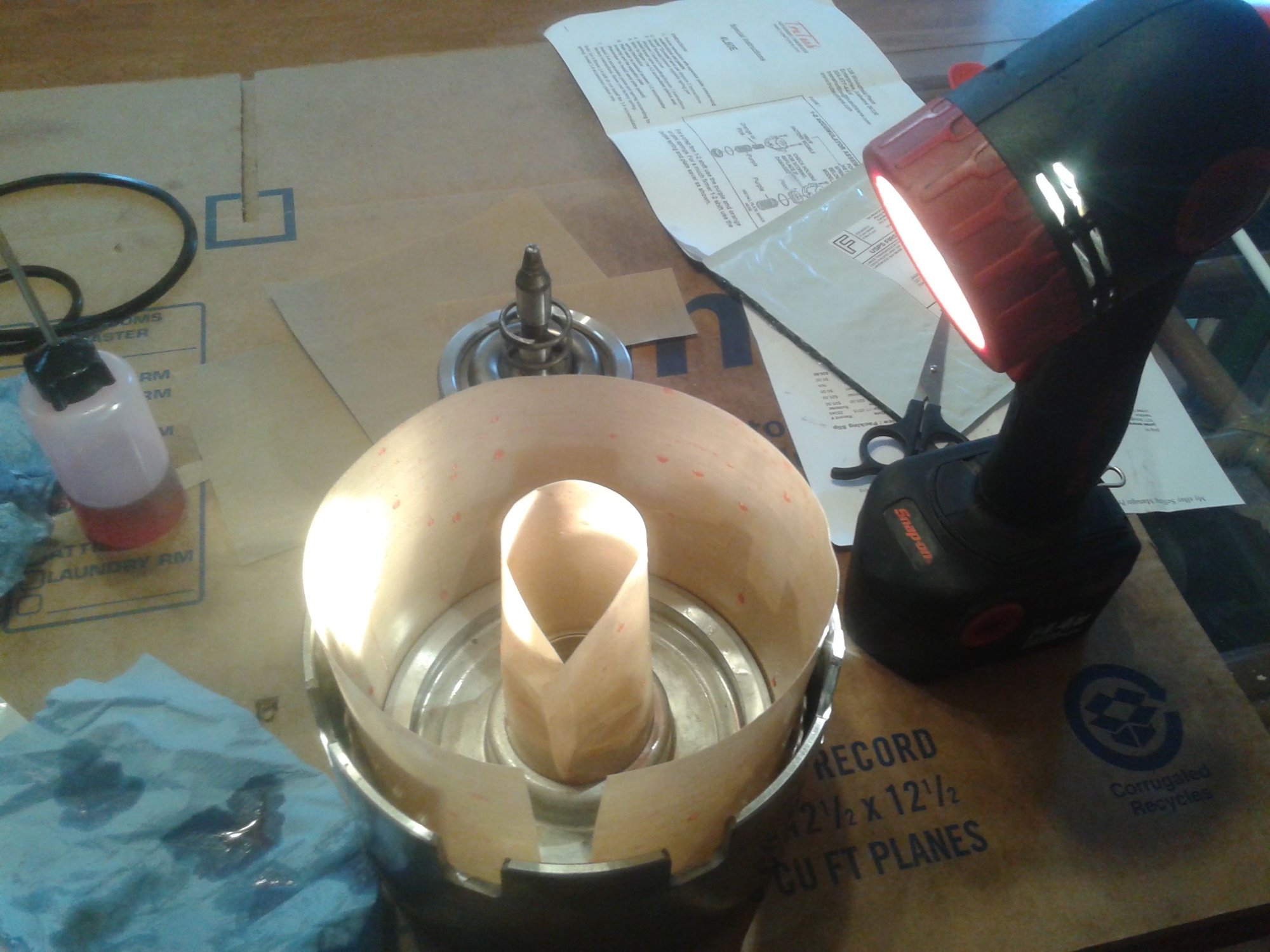

Side note that the reverse input piston seals are a pain in the *** to get onto their bores. I've ruined my new seals! Some thin plastic shim should help funnel them down much better instead of the feeler gauge trick. Hopefully

Here's my idea on getting the piston in the reverse input.
The material is .050 thick Teflon tape we use from work.

Its worth a try. I would lube the seals real well with ATF. I would test install the piston once, take it out to verify the seals are ok, lube them again and the perform the real install.
I find something called the "Lip Wizard" handy for installing pistons with seals. You turn the disk through the seal will lightly pushing down. IIRC on the reverse piston you use it on the inner seal first. Any trans shop should have dozens of Lip Wizards as some rebuild kits include them.

Yeah, the reverse input drum piston was by far the most difficult to get in. The other pistons either went right in or just needed a slight nudge with a feeler gauge.

Teflon film on rev. Input worked so perfect!
