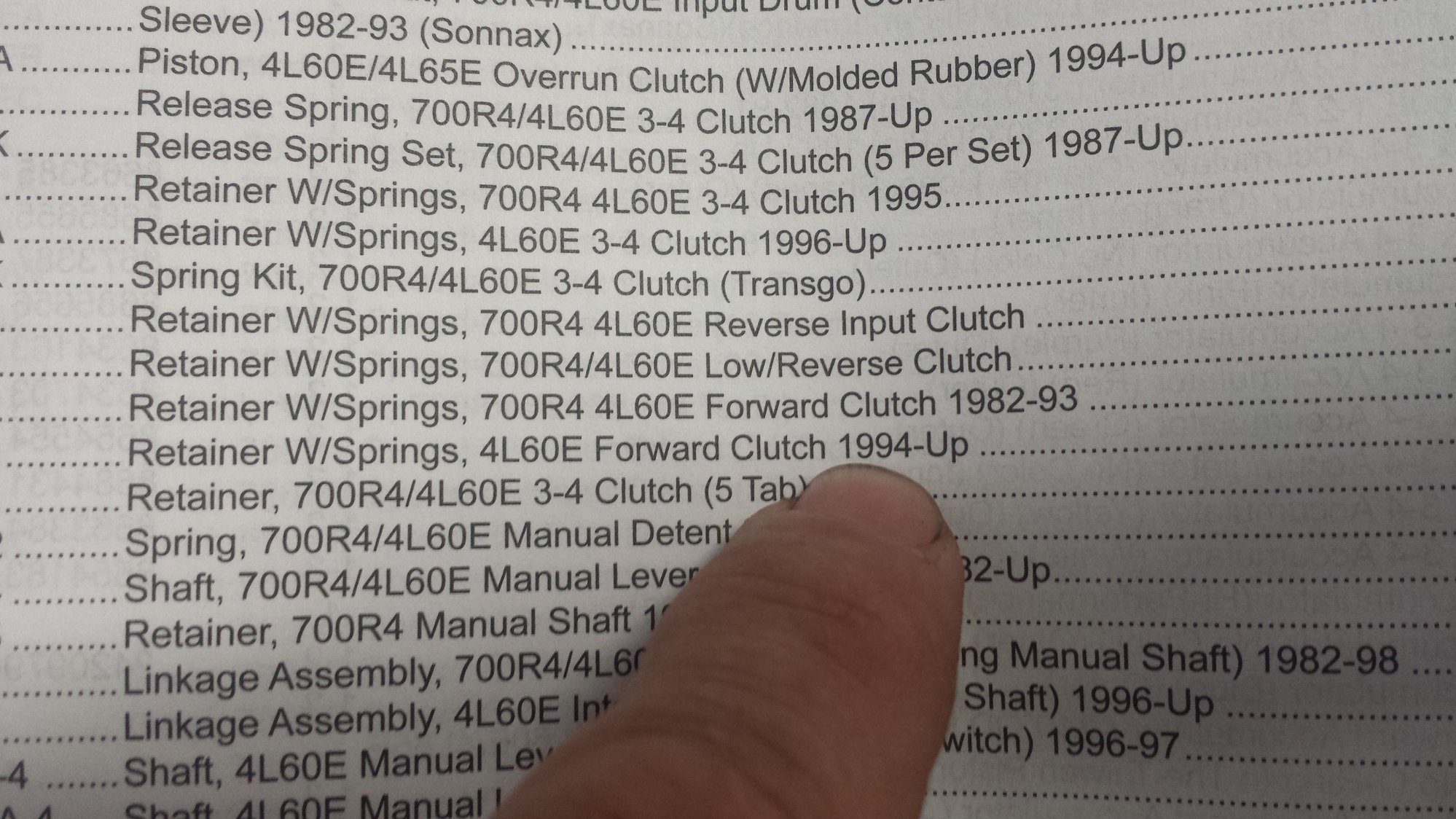

Ok i went to the shop where i buy all my parts from. He cant find a part # for the 3rd accumulator check ball and the book lists the forward spring cage as 94+ and nothing for any later years.

The AC Delco part number for the 4l60e 3rd accumulator check valve is 8634400. Not sure why he wouldn't be able to find the part number.

The AC Delco part number for the updated overrun spring cage that's compatible with the updated bonded steel piston is 24206085.
