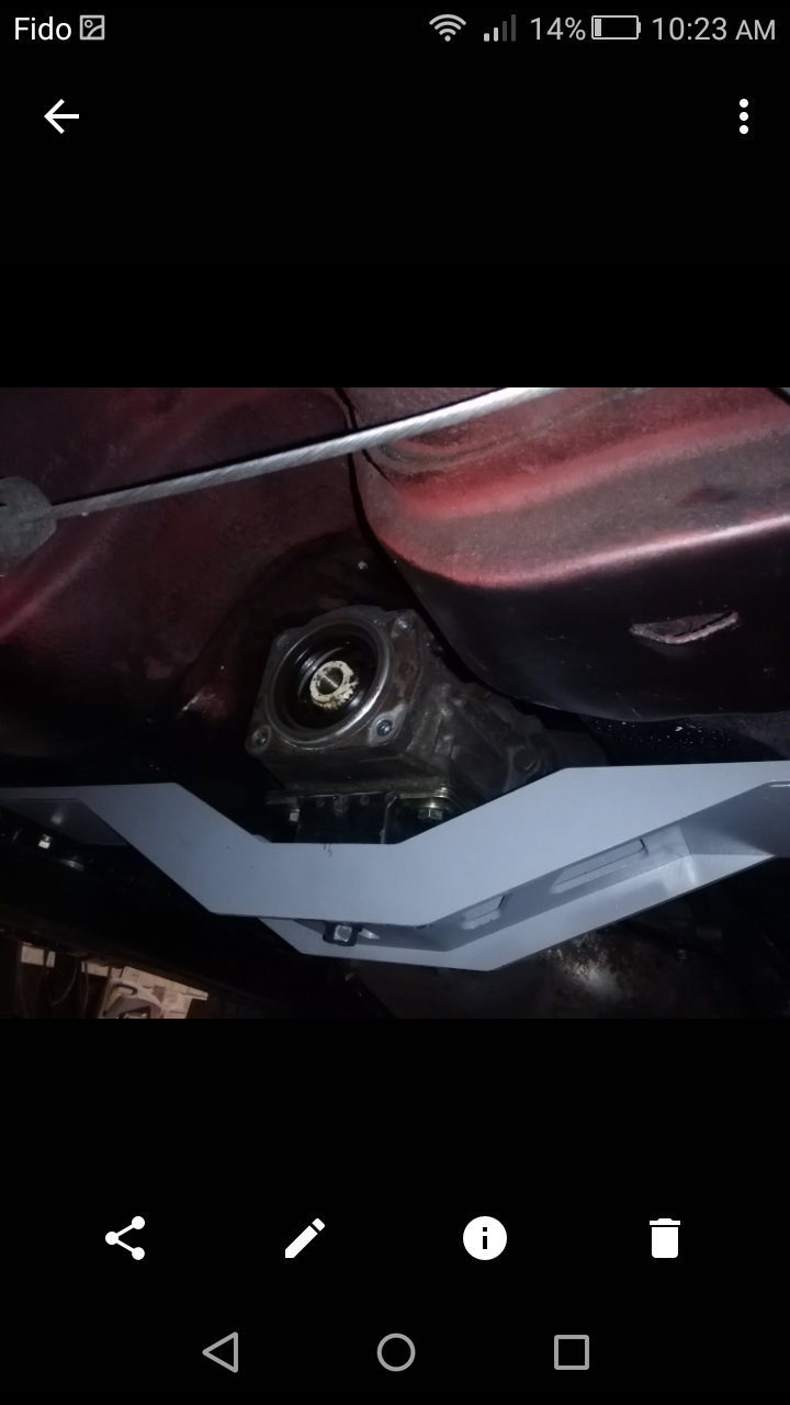

I did LS swap in my 73 camaro I installed 2006 4L80e from truck .now I am having problem with yoke it's too big.so I like to know can I put any thin yoke .my car had original 400th turbo transmission.here is the picture of both yoke. On the left its 400th yoke and on right from medium truck.but the big yoke won't go between the tunnel cuz it's big.so like to know what model of yoke can I buy to install with original drive shaft.

It won't fit cuz 400 has thicker dia from outside and short. the 4l80e has thinner outer dia and it's long.so like to know what should I do now?

I'm having my drive shaft shortened as we speak and the yoke that was given to me from the guy that rebuilt the trans gave me the 400 yoke.
Maybe you have the wrong yoke or seal in the trans not letting it go in.

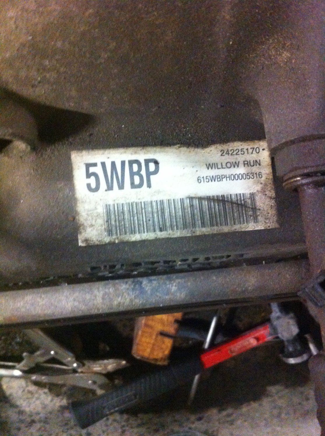

Yes it's 4l80e 32 spline from 2006 Isuzu NPR

here are the pictures

Does your trans look like this?

Yea, the drum brake. Makes since being in the izusu. My tailhousing looks a bit different. This might be a simple tail swap and the 400 yoke will work

my transmission look like this but it doesn't have drum brake .I will try to put back again if it's fit or not.i hope it will lol.dont you think if it fits it won't leak the oil from yoke cuz it's short?

The picture I posted of the trans is from a 1 ton rack body chevy.
Yes its missing whats in my pic.
