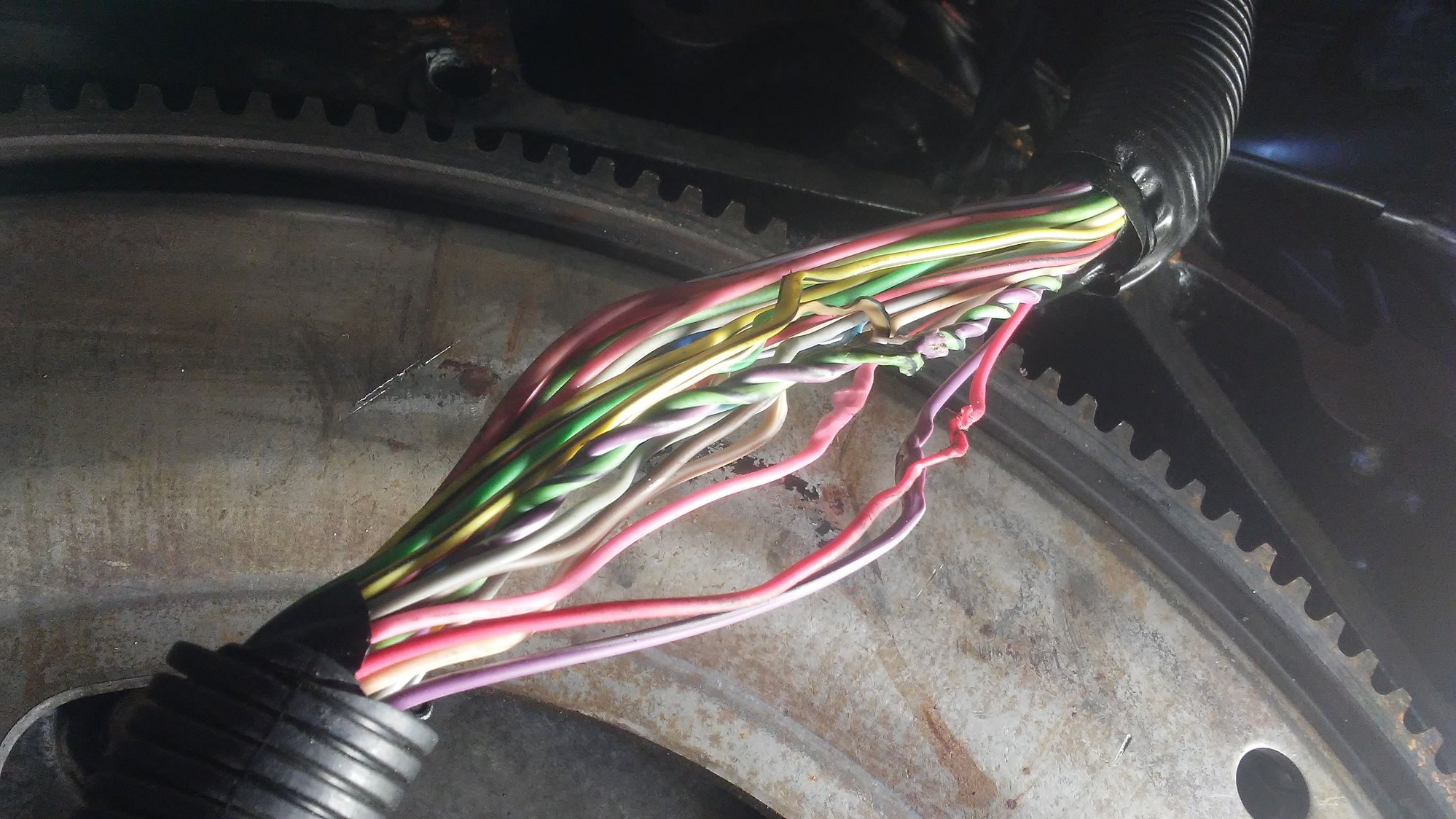

Well.
I'm updating this to let everyone know about my saga and to also come clean.....I fucked when I did the swap.
I pinched the harness at the top of the bellhousing. Guess which wires were pinched?
Speedo wires and the pink 12v wire. Once I cleaned up the wires, I keyed on and verified 12v on pin E at the connector.
Old Jan 28, 2018 | 08:46 PM
Game ova's Avatar
Joined: Jul 2015
Posts: 3,012
Likes: 48
Originally Posted by madmann26
Well.
Congrats man, at least you found the problem. You must have forced the transmission to mate up with the block. I nearly did something similar a few weeks ago, kept fight tranny.... then seen the wires.
