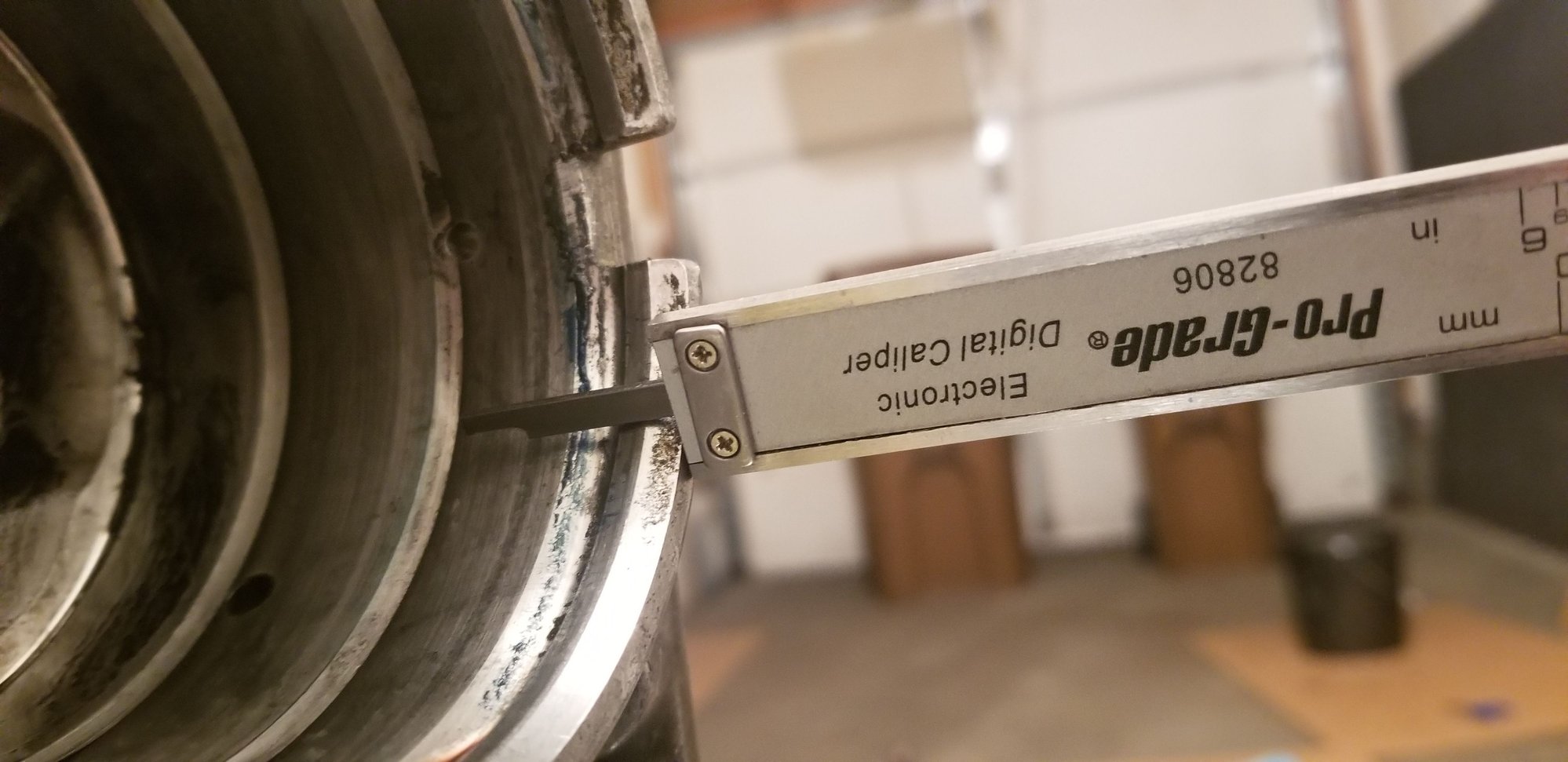

Another good way to measure band clearance but takes two people is with a digital caliper. Use the depth finder side and put the end on case like in the picture below and the tip on the servo cover. Then push the servo in and have someone take a measurement the same way. Subtract the two numbers and you have your exact clearance.

I do the same thing as above, but use a long rubber tip woodworking clamp near the cutout for the shift linkage and use it to draw in the servo and hold it in place. Makes it easy to get an accurate repeatable reading.
