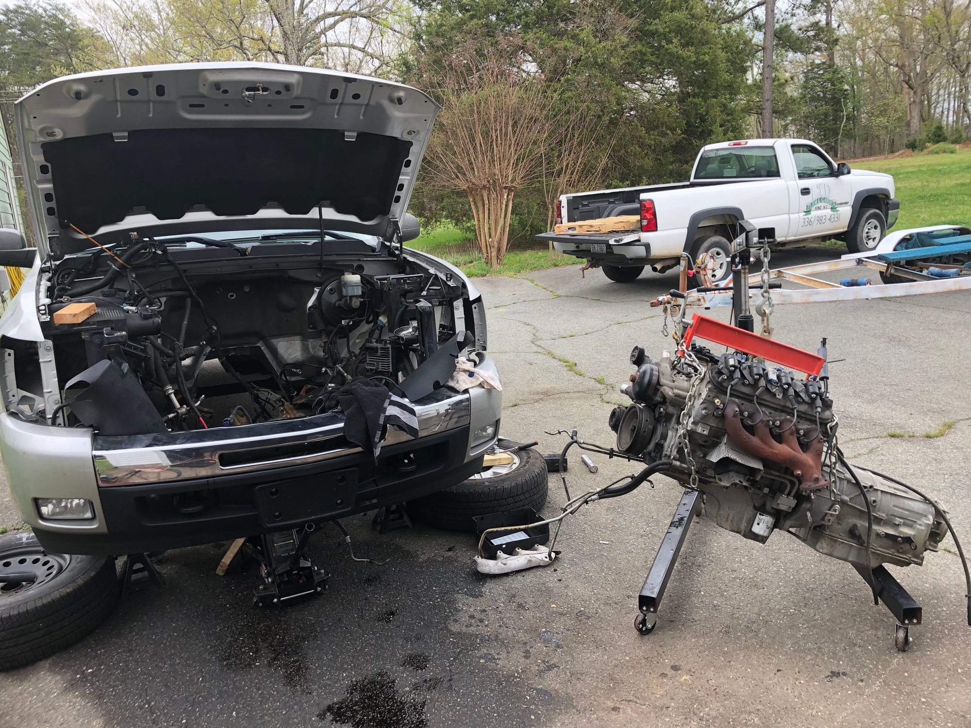

If you go to the Advance Adapters site it specifically says the 6l80 is not a good choice for Jeep transplants, but I suppose it could be done. Also I meant CV shafts, not double cardan. For reference I pulled my 5.3/6l80 combo out yesterday, it’s quite long. Good luck though if you can pull it off!! My 3-4-5/R drum is cracked I’m almost positive, which is the main reason it’s out now.
