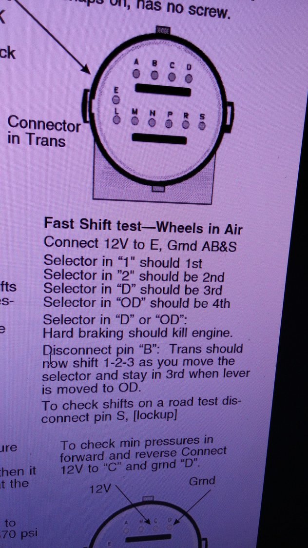

do this. It will tell you if the problem is the harness/PCM or the transmission.
