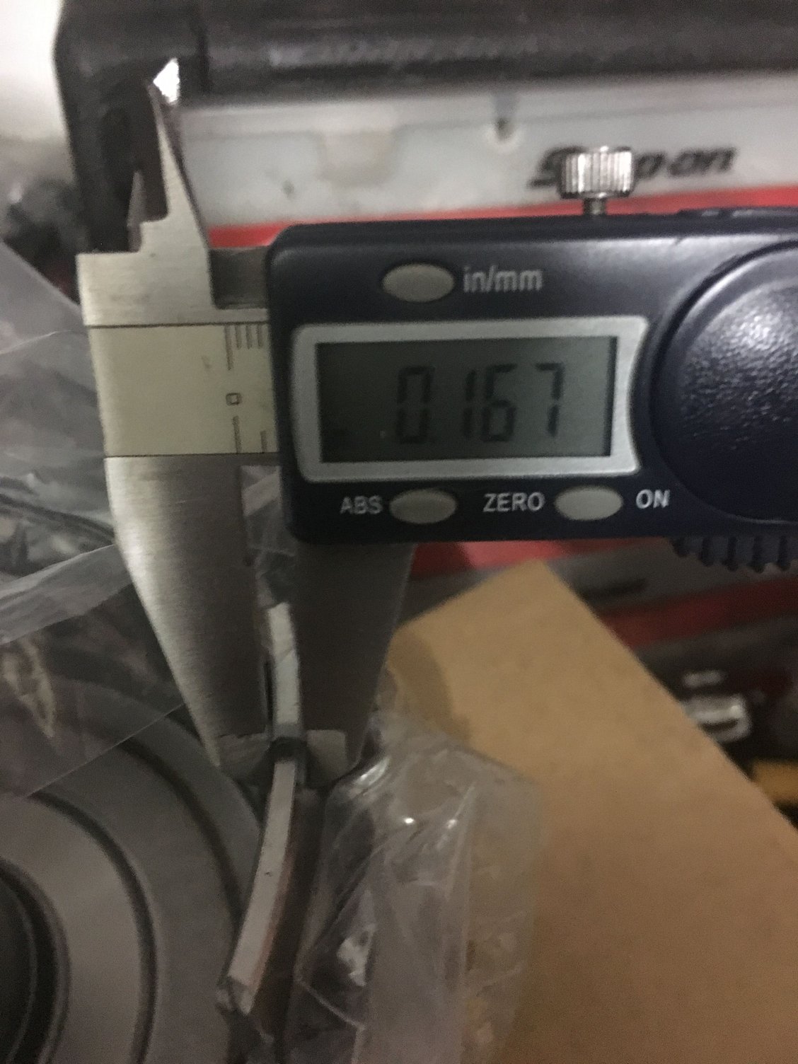

Wanted to see if anyone else has run into this or if this is the new. I recently purchased a new ACDELCO reverse input drum from a very large transmission part house. Came brand new in box. The issue that concerns me is that it is considerably thinner than stock one that I removed. Now ACDELCO should be ACDELCO right? The last one I purchased I got from GM dealer direct 3 months ago and was identical to the old drum. The GM dealer unit cost $40.00 more and had the same part number. I posting up a picture of the old and new with measurements. Just really wanted to see if this is the new norm. I have contacted the parts house and was told a offshore maker is now suppling acdelco with these drums. Guess my only concern is the housing being thiner wall and possible heating up quicker causing issues. I am running a wide carbon band. This trans will be behind a ls2 in a Jeep and will see offroad use and abuse. See pics and let me here what you think. I have already contacted the well know part house and they are working on it but are un aware of the change.

You want to measure further down where the band rides, not the teeth. Since it looks like the teeth are thinner, that would be fine.

My current caliper does not reach that far down but I will have one shortly that will. FYI these are apparently now supplied to AcDelco by a company Called Tsang Yow out of China. This drum was off a pallet the parts house just received. I will measure and update later. thanks for the response.

Well that post was surely helpfull. I did a comparison measurement with the caliper I had and it looks like the band area Difference is negligible there’s a very small difference could be due to the way I was measuring it since I didn’t have the proper caliber but for ***** and giggles here’s what I came up with good to know thanks for your helpful post. Again I made due with what tool I had in front of me . I have a buddy with a deeper caliper stopping bye latter today.

I tried uploading from my laptop but still not working. Difference between the two is .009" probably not a big deal. the old still being thicker.
