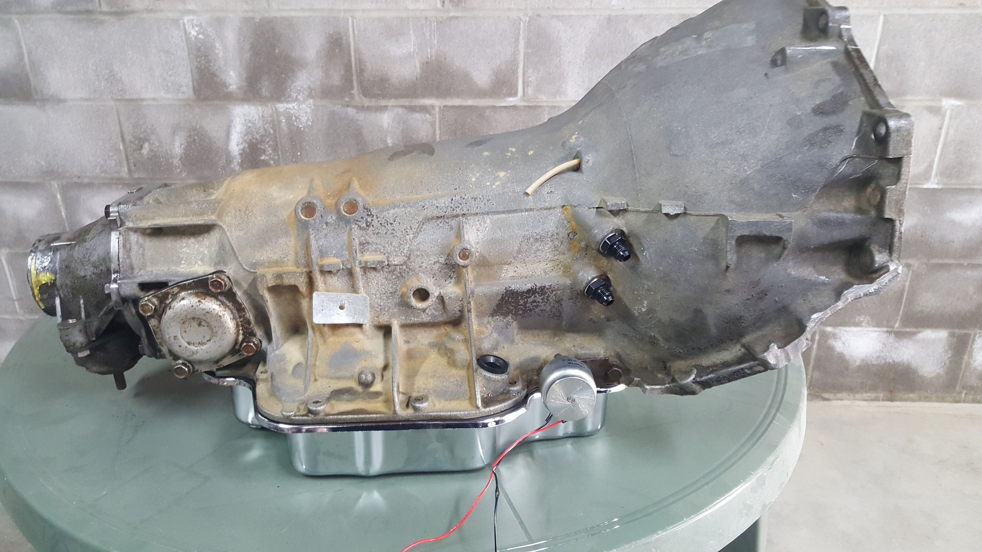

I couldn't find this anywhere on the site....how would I clean the transmission case at home? Got the oil, sand and crud off with a toothbrush, scrub brush and paint thinner, but how would I clean the inside? Suggestions anyone? Jake

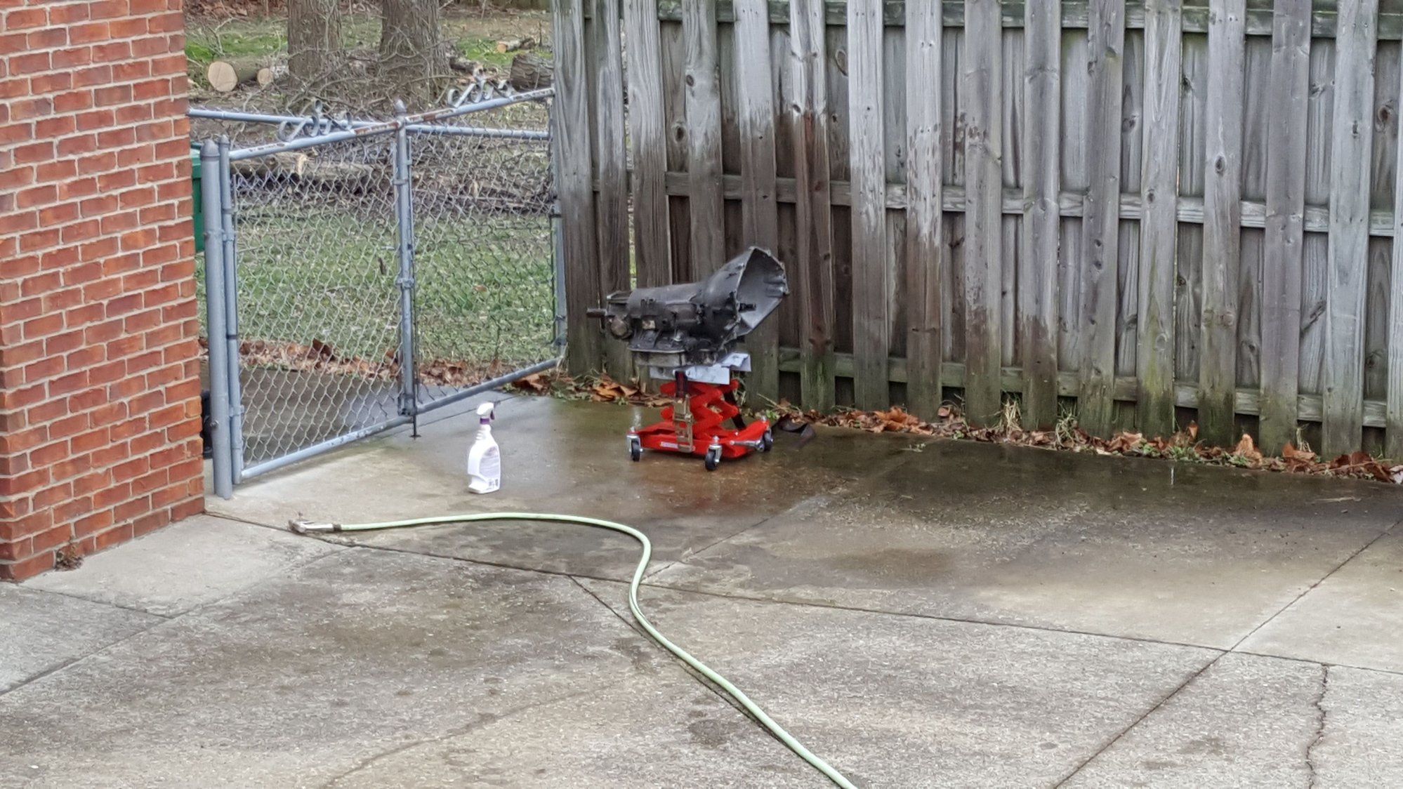

Harbor freight electric pressure washer ($79.99 with coupon) and a spray bottle of Totally Awesome ($1). Soak everything good, 3 or 4 times. Spray it off. Done.

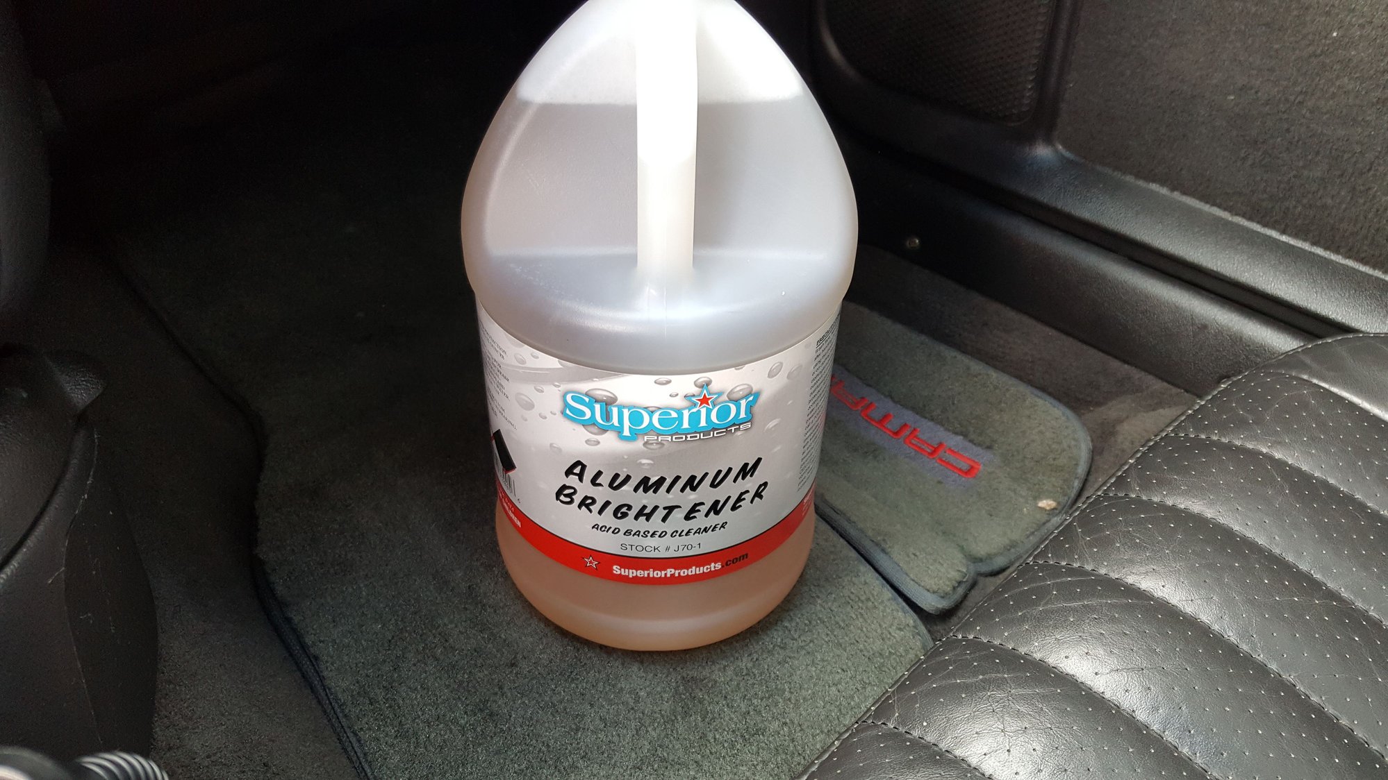

Water hose and this, case will be immaculate.

The aluminum brightener is great. It will work very well. I use a different brand but the real active ingredient is the same...hydrofluoric acid...which is why i've been reluctant to recommend it.
Just be careful to not let it sit too long (you'll get a white powder that can be tough to clean) and more importantly make sure you wear proper protective gear. I'm the "no gloves in the solvent tank" kind of guy and I still firmly believe you need your PPE for using anything with hydrofluoric acid. Nasty **** if you get it on your skin...even nastier if you get it in any mucous membranes (eyes/nose/throat)
But I digress...if you use a brightener with hydrofluoric acid...you'll be very happy with the results. Follow the instructions on the bottle

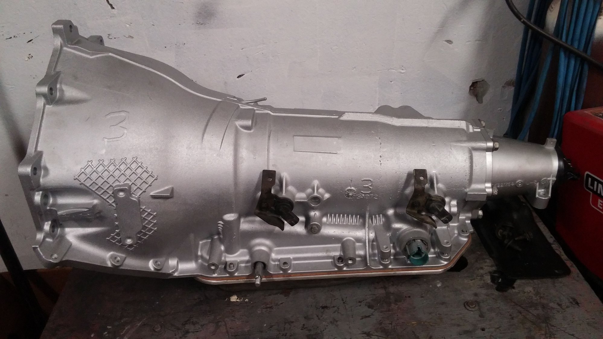

worked good on this 80
