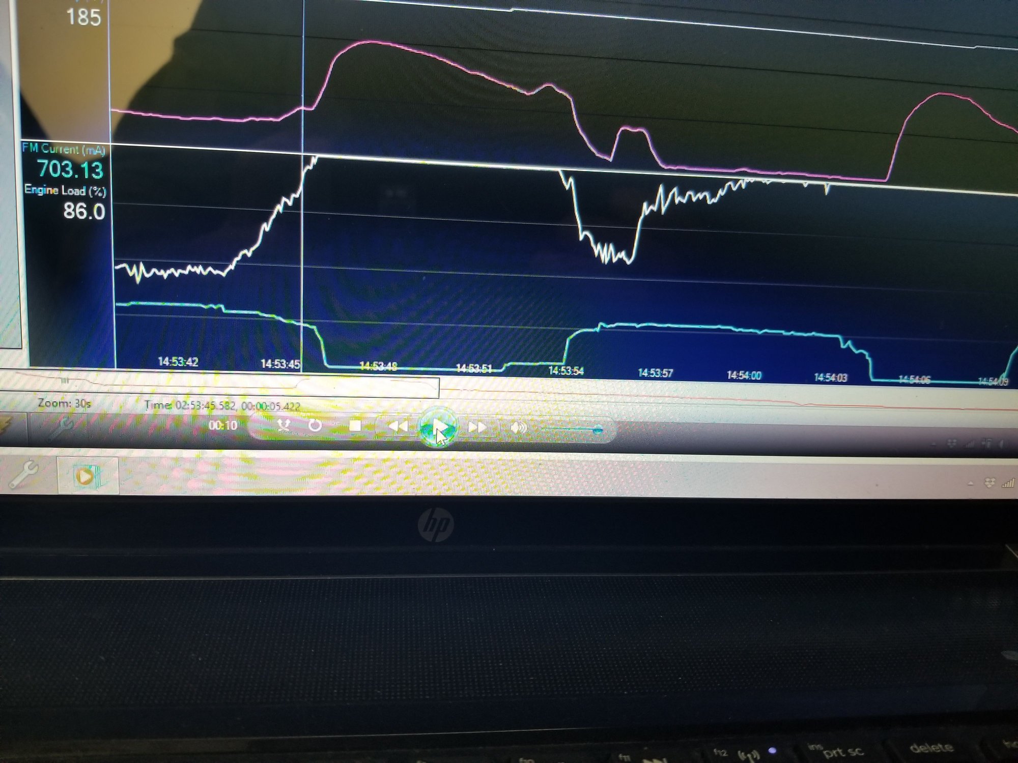

Today I logged force motor/PCS current. The commanded current to the solenoid matches up with the pressure gauge reading. The PCM's signal sent to the PCS solenoid is not a smooth curve. It's very abrupt. I verified the force motor table is stock. This seems to indicate that the line pressure is doing exactly what the PCM is telling it to and it's not a sticky valve causing the erratic line pressure rise. The random low pressure at idle problem continues and the PCM is commanding the same PCS current at idle every time. I'll link a log video to show what I'm talking about.
https://vimeo.com/299327385

The blue line at the bottom shows the PCS current command from the PCM. It matches the pressure gauge. Too bad I can't graph out the trans pressure.

Well if the force motor current is the same with either pressure condition , I would have to think a valve or solenoid issue, A leak while possible would IMO tend to be consistent . Not up one time and down the next but anything is possible .

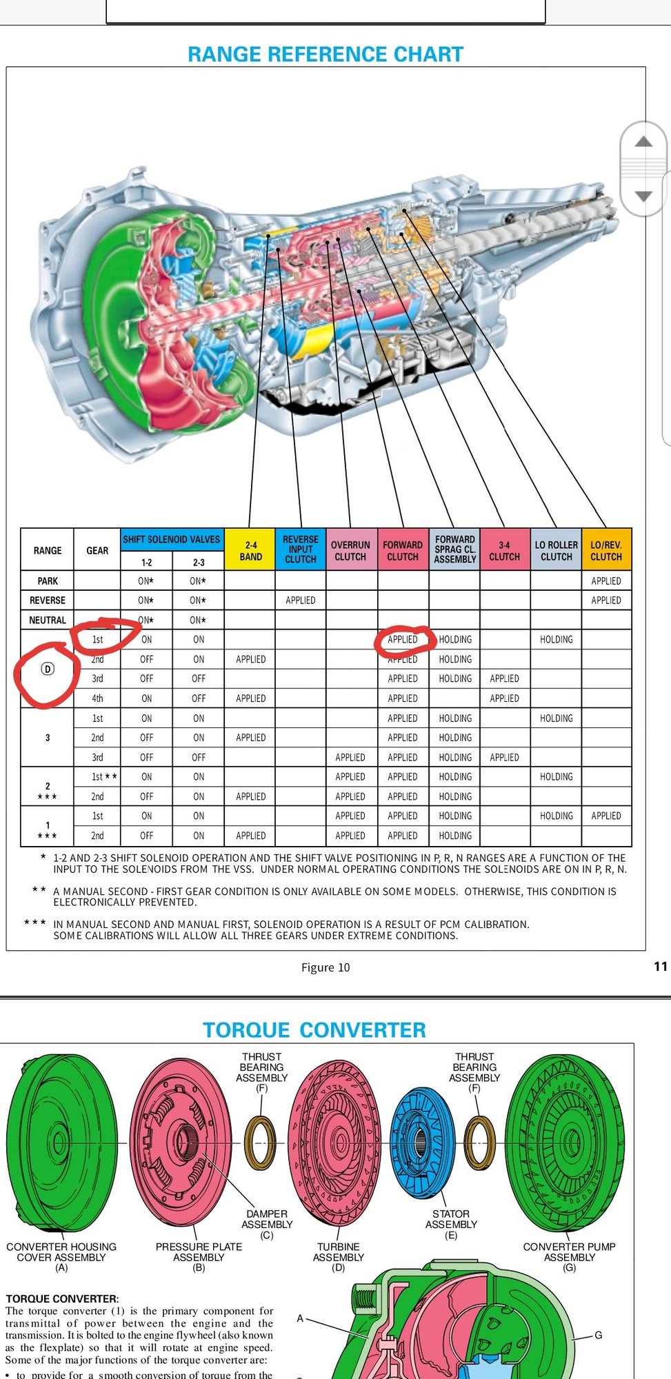

I have another good valve body. I'm going to swap it in and see what it does. If that doesn't work and I'm looking for a leak it's going to be something in the forward clutch circuit correct? Nothing else is applied in D1?

in d1 the following is applied:
-forward clutch
-low/rev clutch
-overrun clutch
The pressure usually does jump around like that and the force motor current does as well. You should also log maf/map/tps when logging the pcs current and you will see that there is a fairly decent method for the madness that you see in the graph. The pcm is only giving pressure (controlled by FM amperage) when you actually need it.

Ok thanks for the info. It happens in Drive in 1st gear only. I don't think it happens in manual 1st but I will try it again tonight. Maybe I worded it wrong. I'm working off of this:

Yes that's correct. When people say D1 they typically mean manually selecting 1st gear.
