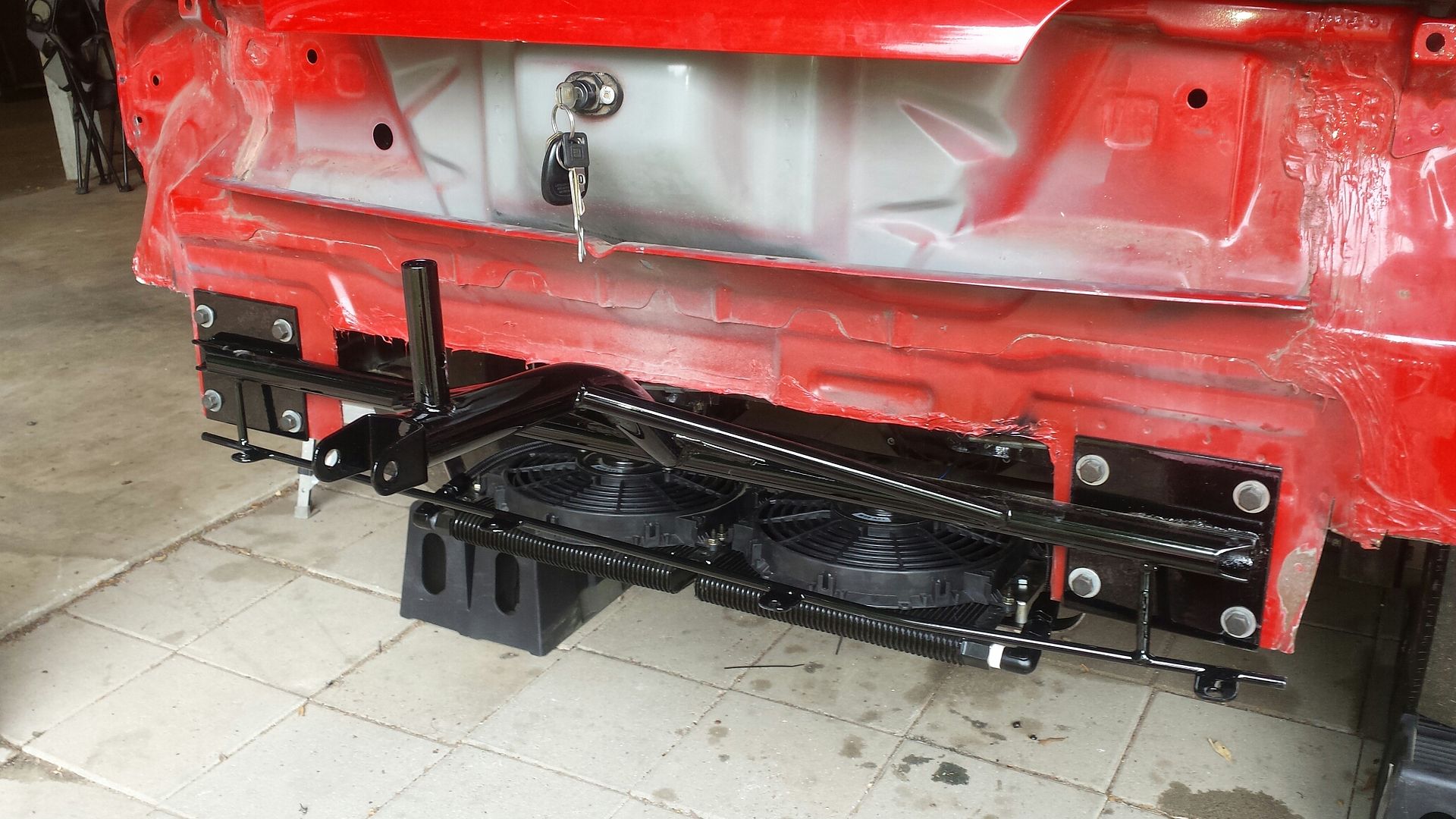

https://www.ebay.com/itm/173862006149
I run twins

Originally Posted by 01ssreda4
Damn that is beautiful! And a great use of space!
Did you do the steel fab work to mount those two stacked plate coolers?
I really love the design! Using factory bumper mounting locations and I assume the car uses DSUZ fasteners to mount the bumper cover???
Anyway, AMAZING!
