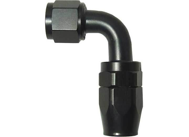

Poor Jake you gotta keep letting people know the junk brake isn't yours lol, Jakes said he would flow some banjo cooler fittings for me on his trans dyno for some real word results, thats customer support ,ive been wondering if they impede flow , pressure is probably higher due to the added angles of the fittings ,but do they restrict flow in any way is the question , ive been doing some very tight tunnels lately with remote coolers in the rear and its use these fittings or make a new bump in the floor, happy new yr
Old Jan 2, 2021 | 01:22 PM
Is this test going to be done with the $45 banjo fittings that have sold over 500 units or cheap $15 banjo fittings on ebay?
In terms of flow-restriction... i do not see any difference between cheap and expensive banjo-style fittings.
I try to avoid any and all hard-90* degree fittings (especially with AN-fittings).
AN-style hose-ends that make a 90* degree bend (or any angle other than straight) using tubing will always be superior to a 90* degree fitting.
This will always flow better:
Than this will:
These Banjo-style fittings:
Generally perform like the 90* degree fittings as apposed to the hose-ends.

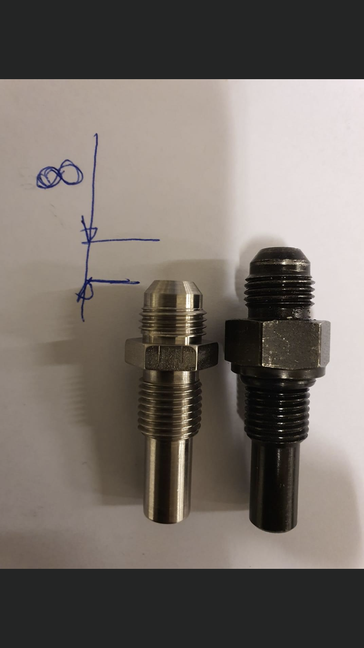

Yes, those are the Sweet Performance banjo fittings I was planning on using. There was a discussion on facebook and I guess many are using them without any issues. I like the idea of the homemade straight ones that are shorter than the ones you can buy. Probably not that much less clearance on these with 90 deg AN fitting vs the banjo fitting. 8mm shorter.
