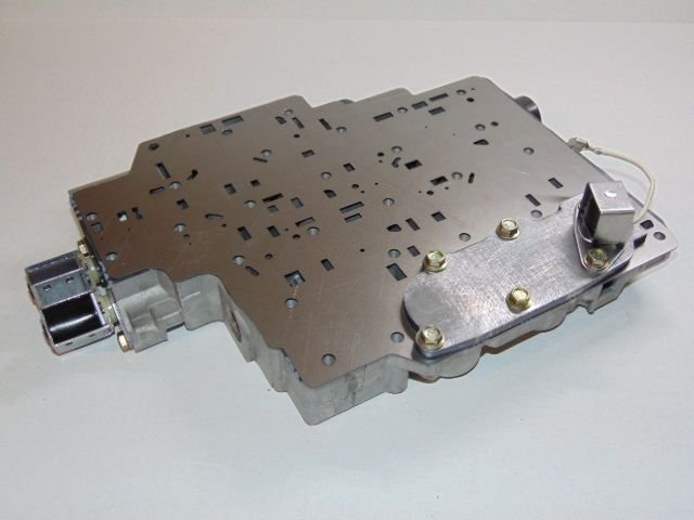

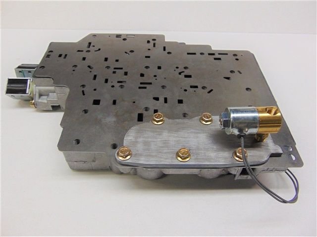

So...which one of these is most recent from CK?
I found both of these on his site.
Looks like one is a nitrous purge solenoid (which is just a generic parker solenoid) and the other is a th400 detent solenoid.
I know a can solenoid can exhaust a hell of alot of fluid...what about the detent solenoid? How much can it really exhaust?
That can style solenoid is.
