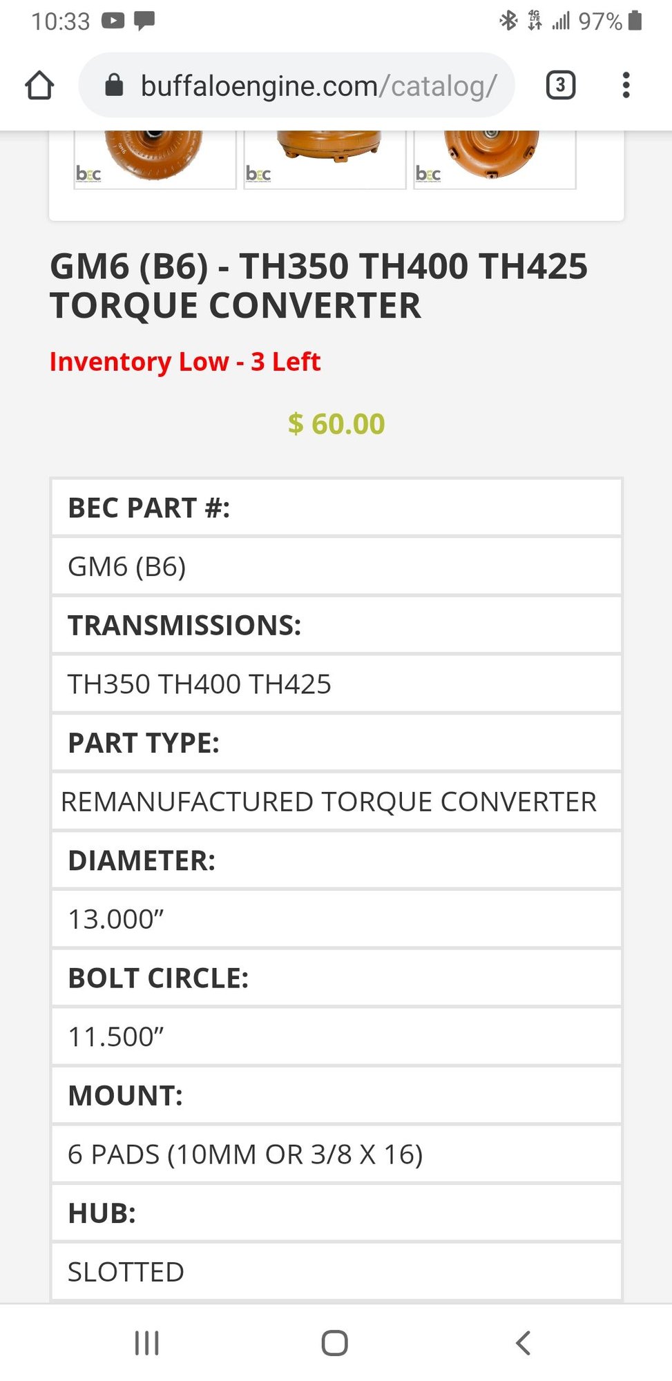

You mean this one? Said 15-1800 on the website, and I'm not sure I'd put that behind a turbo mill.
There are more than a couple GM6 converters. Some have 3 rows of fins some have 2. There is nothing in inherently wrong with using it on a turbo. It isn't going to perform like a Yank but it cost about $250 and the Yank is about $900. The converter guy is going to change a couple things inside it and try to get me closer. He said the same thing as above, if i dont have the torque it needs the stall will lower dramatically so you actually lower the stall a bit and it will raise it for that given engine. Ill give it another shot after its changed and if it still isnt close to what i need ill drop the money on a Yank because they have the stalls figured out already.
But honestly I'm not worried about the thing breaking or the turbo being to much. Not ideal for the setup but certainly not weak or anything.
