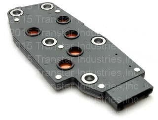

The trans temp sensor is located in the manifold pressure switch. You can access manifold pressure switch by dropping the trans pan and filter. Then just 5 bolts hold it on, 3 short and 2 long. Most GM vehicles won't engage lock up until a preset temperature is reached, I'm not sure if it is based on engine or transmission temp. You will have to do some research on that to be sure or hopefully someone here can confirm. But there does seem to be something wrong with the trans temp circuit that needs checking out. My diagnostic theory when dealing with something like this is to repair what you know is wrong and it may fix the main problem that you are dealing with.

After rereading your 1st post, I don't think your problem is related to the temp sensor. It could be that the converter regulator valve bore in the valve body is worn and losing pressure. It could also be the lock up clutch in the torque converter. Fitzall.com makes a converter regulator valve that will work in a worn valve body, I think this is the part # for your year trans SKU# A74741CB.

Sonnax has a repair part as well but a reamer is needed which is about $100. I will be purchasing the fitzall part, manifold pressure switch. Should I change the solenoid as well? Any other parts should be replaced while in there? Also, what type/ brand filter and gasket should I use? Acdelco brand ok? Crossin my fingers the torque conveter frictions are still good. Thank you so much for the help. Extremely appreciated!

Thank you vorteciroc for a detailed explanation. I just purchased the fitzall repair, manifold pressure switch, filter, gasket and oil. The sonnax is a quality product but the fitzall is a much easier install for a backyard job. Do you think the tcc pwm solenoid should be replaced as well? If someone could please answer me soon. I ordered all the other parts and would like to have this done before further damage occurs.

Bad news today. Installed the Fitzall A74741CB, Tcc pwm, manifold pressure switch and the problem is still there. I did notice while driving it after the parts were installed, I am getting a few misfire counts on all the cylinders. Each cylinder is giving me any where between 1- 4 counts all at different times. Would that anything to do with a code p0741(which has gone off)? Am I looking at two different issues? Is my next step a torque converter? If so, what is a good company to get a stock rebuild. Need this fixed and it is driving me insane.

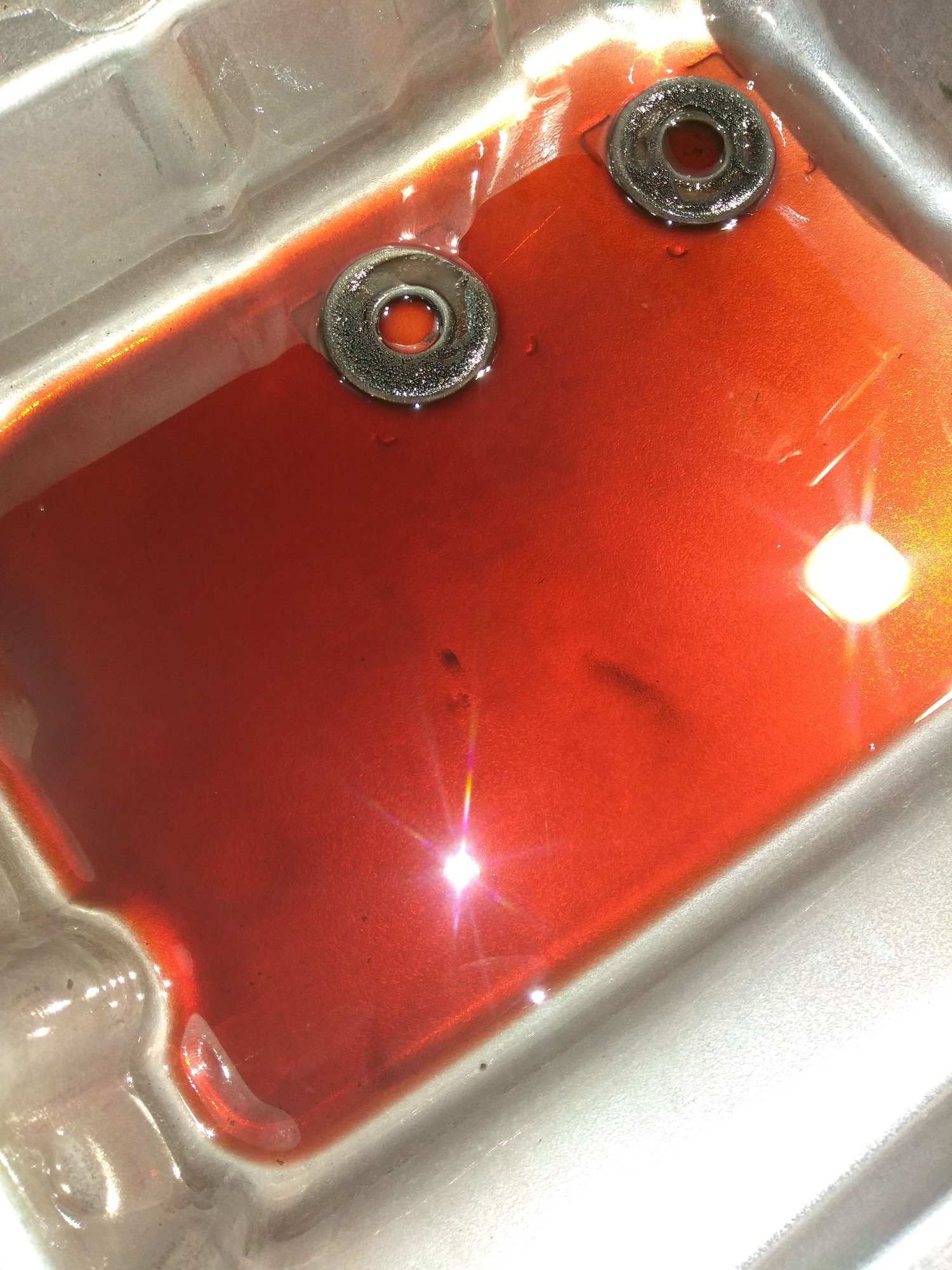

This is what the pan looked like when it came down.

Looks pretty normal.
Fix the misfires. You can add a superior TCC valve in the pump if you want to and have the pan off...but I certainly don't think you NEED to.
