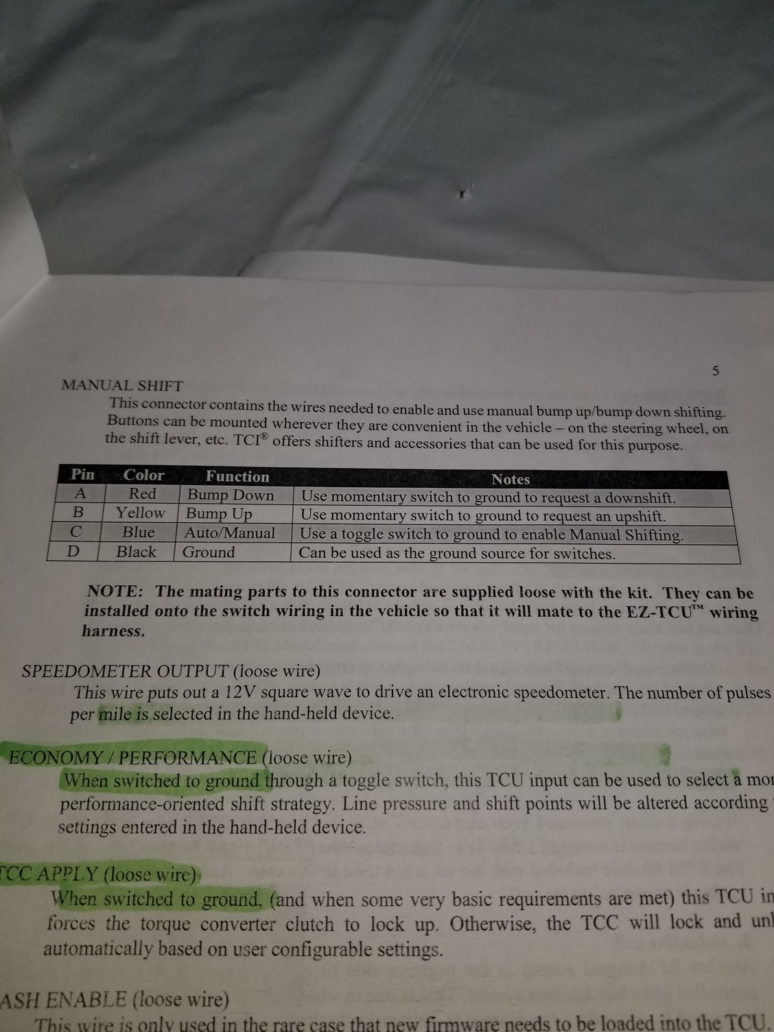

After Reading again . I have to switch it in manuel mode. In the tcu it written to switch a ground to the pin C in the manuel shift connector and the pin D can be used as ground source for switchs...

Posts: 28
Tcu instructions

The pin D in manuel mode connector can be used as a ground source... Should i use it for: tcc apply,economy/performance and manuel mode swtichs or use a chassis ground?
