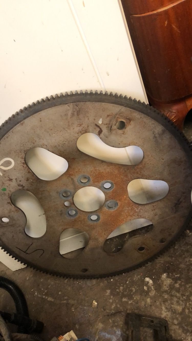

So, I need that adapter ring and move the bolt holes, correct?

Yes that is the later flexplate which will work with the adapter ring. With the converter holes you have to check them before fitting the trans. Flip the converter over on it's snout and put the flexplate over it as it would be bolted up in the car. Depending which converter you have there are differences. With that plate you will probably have to drill new holes for the converter.
Thanks alot man, I appreciate it!
