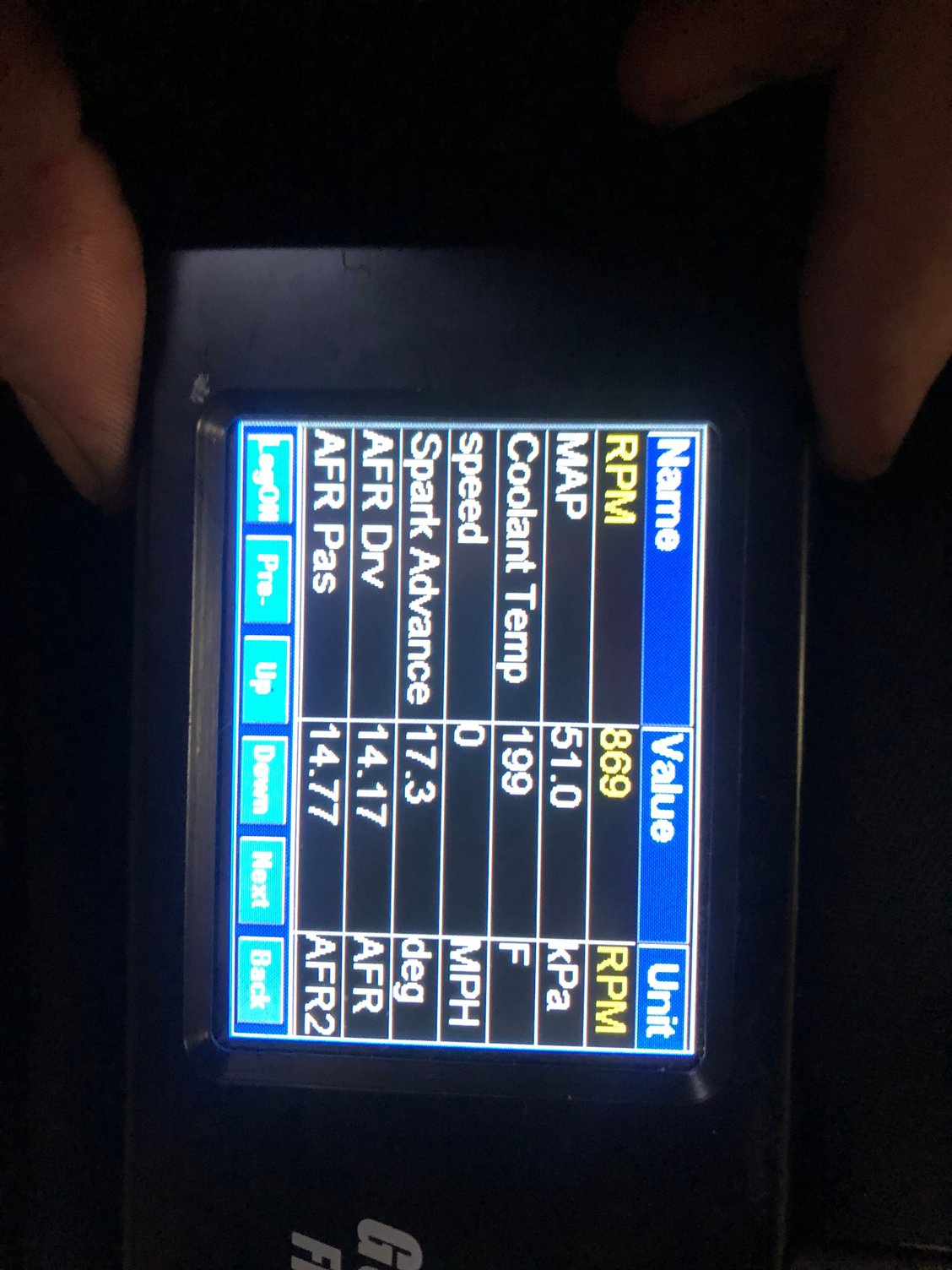

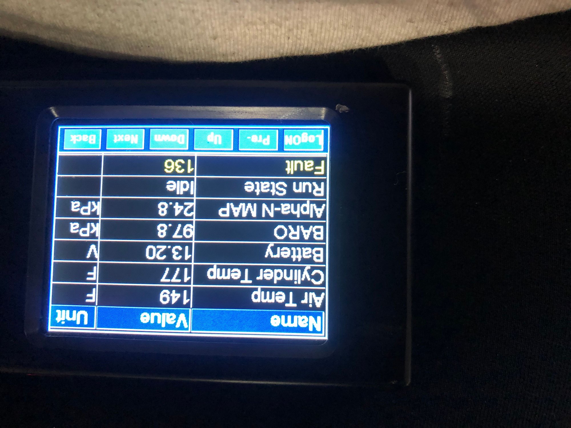

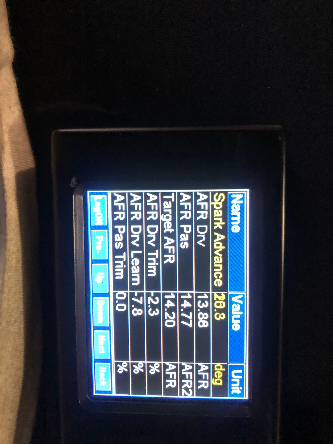

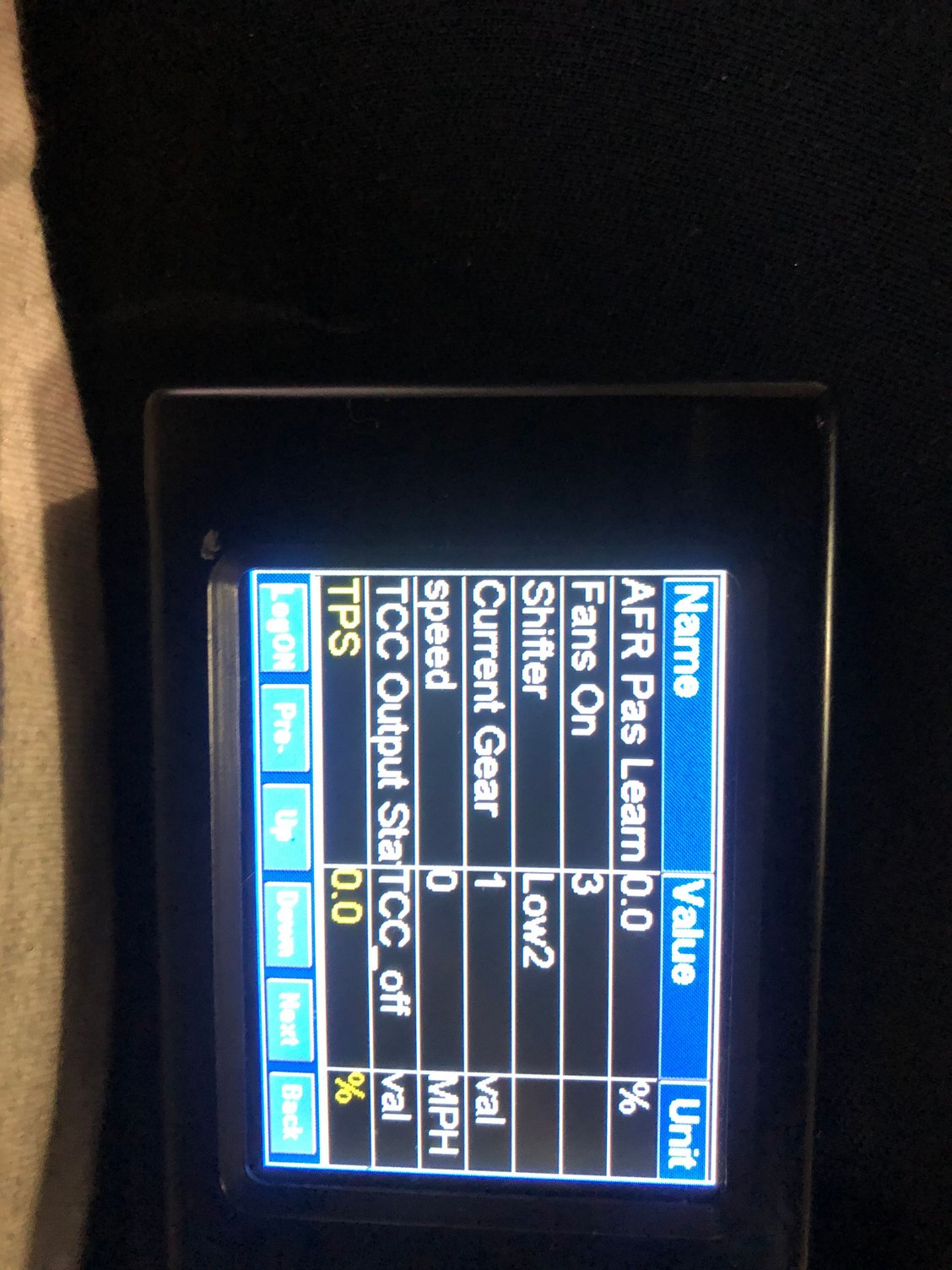

Default My tune don’t know if well help

Can you log what the vehicle is doing when it is shaking and limiting speed? I'm sure someone much more well versed in LS tuning than myself will see something that could lead to a fix.
