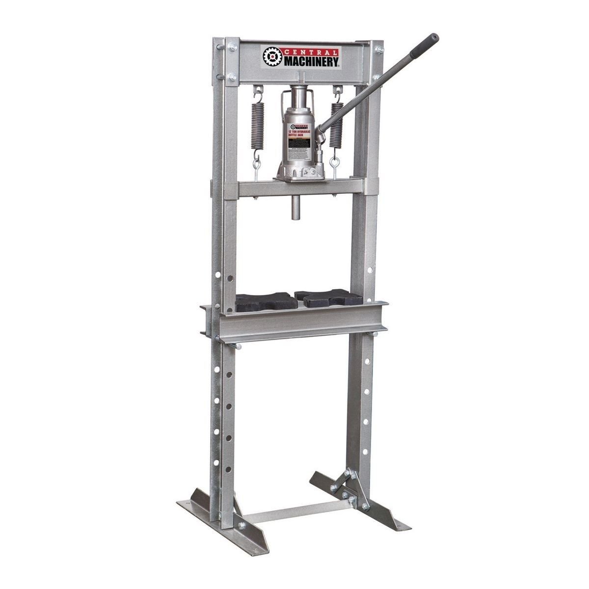

If you are going to rebuilt the transmission yourself...
Get yourself some snap-ring pliers.
Also you are going to need a transmission shop to disassemble the drums and maybe change the bushings.
Should you want to try this completely on your own...
Purchase a small press from a place like harbor freight ($130.00):
and a cheap clutch drum spring compressor off of Amazon or EBAY ($120.00):
Good Luck!
