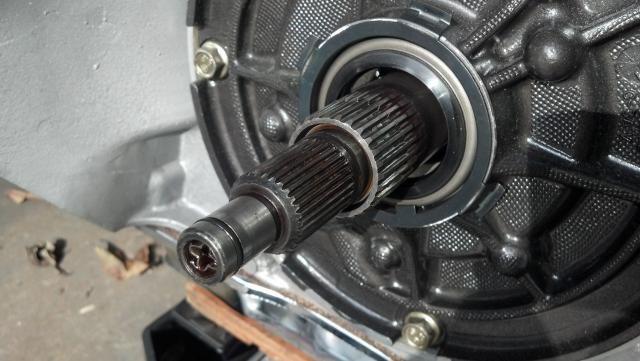

ok im here to update. swapped rear main seal without any problems. i decided not to replace any seals in the transmission. i put a new filter and gasket on it though. the transmission went in pretty smoothly considering i was doing it all by myself with no tranny jack. i thought the exhaust pipe under the transmission was going to be a problem because this new one is a 360 degree bell housing. but i jacked it up and it went right past the exhaust pipe and bolted up nicely to the engine. torque converter/flywheel would not move at all even with a flat head screw driver. when i bought this "new" tranny" they had the torque converter bolts in the torque converter and i forgot to take them out. so i had to take it all back out. remove the torque converter bolts and then inspect for any damage. there was no damage that i could see to the torque converter or flywheel.
so thursday, up i go again with the transmission and get it in place. got all the bell housing bolts in and the troque converter was about 1/4" or less away from the fly wheel and it spun freely. no noise or any kind of binding. got the cross member in and went ahead and put the carrier bearing and drive shafts (two piece) back in.
friday it was a cold rainy day and i didnt do anything.
today i am going to be climbiung back under to figure out what i need to do with the tranny cooler lines. im also going to be hooking up all the electronics as well. so far i have a good feeling about it. i just hope to get 5 or 6 thousand miles from this transmission. that will buy me enough time to rebuild the **** out of the original one.
i will post an update later to let people know the end result. im doing this by myself without any kind of jack stands or anything. there is just barely enough room for me to climb under it and work on it. when i was trying to get the bell housing mated up, i was layed with my feet towards the bell housing and i had the tailshaft in my hands. i was pushing the bell housing with my feet while wiggling it with my hands. worked pretty damn good and must have had it at the right angle because it went past the exhaust and fell right on the guide pins lol. it was a miracle i tell ya!
anyways, thanks to everyone who has helped an inputted on this. i will update everyone shortly with a resolution. thanks again

The 2-piece case transmissions for Gen III and IV differ in the bell-housing depth...
The stator-support is 0.255" longer and puts the turbine shaft forwards 0.255" further than the 1-piece type.
Different Flex-plates and torque-converters are used to accommodate these changes.

The 2-piece case transmissions only differ in the bell-housing depth...
So... depending on which way the combination is flipped...
There may be not enough or too much torque-converter spacing.
But that can be made up for with a different torque-converter.
Also, if the combination produces too much torque-converter spacing, then washers can make the union work properly.
