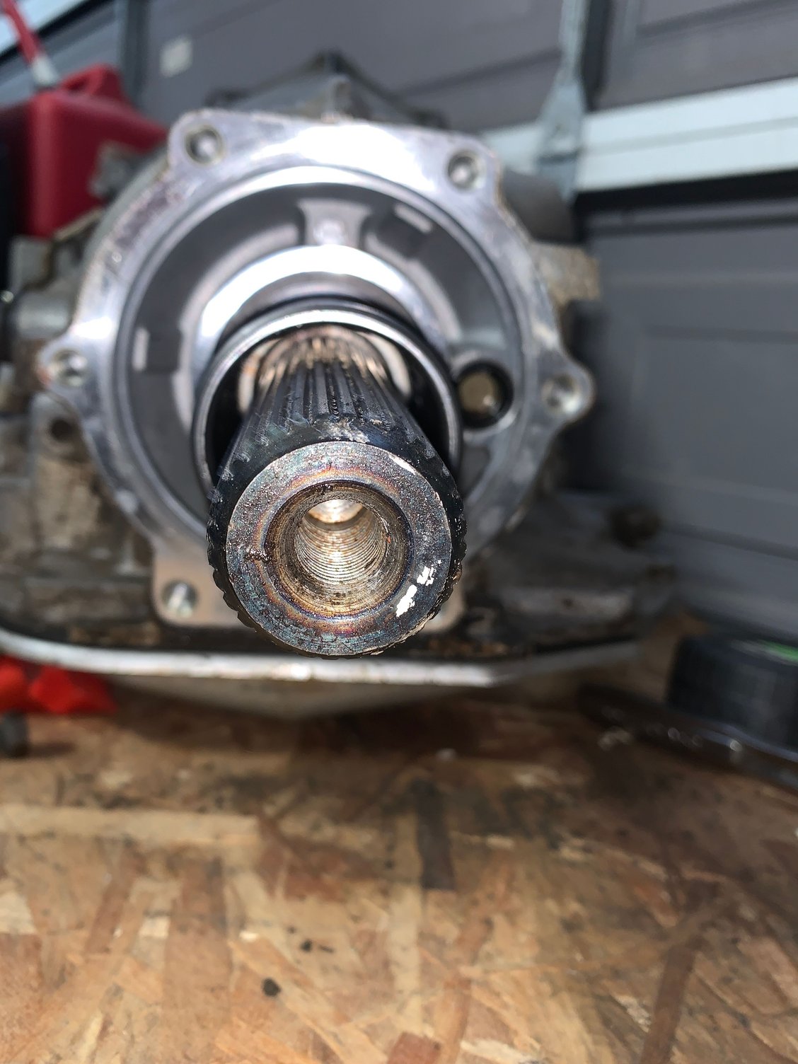

Hello everyone, I have this 4L80e trans that I picked up from a buddy and Im trying to find a yoke for it. Its a newer style trans with the cooler lines spaced out but doesnt have the top bolt hole. From what Ive gathered, a 32 spline th400 yoke is what Im looking for but theres so many. Vented/Non vented, Counter bored/Non Counter bored, Long shaft/Short shaft etc. Due to the metal sleeve, I cant tell if theres an o ring near the base of the output shaft. Ive included some pictures hoping someone can lead me to a part number for the correct yoke for my application. I dont want to have to cut or drill anything. Ls3/4L80e combo into a 71 442. Also, where can I find another rubber boot? As you can see mine is pretty torn up. Thanks in advance.

Long-Full spline (not counterbored) non-vented.
Since you have that cup and o ring you technically could use a vented...but there is no need or reason to.
Spicer 3-3-5551X would be fine. 1350 u joint.

I plan to run a Fully Splined Output Shaft & a Fully Splined Slip Yoke regardless of what the 4L80E that I buy comes with as I will replace the output shaft with part number 24204289.
Counterbored Yokes that are for use on Bolt-on Yoke Output Shafts have a tendency wobble around & cause vibrations, Especially on 4th Gen F-Bodies.
I plan to run T3-35571HP Yoke with the full spline output shaft 24204289

That 24204289 is the output shaft he has
The cup around the shaft is just to seal a vented yoke. It was an easy way for GM to keep yoke consistency regardless of shaft.
The spicer number will work...the T3-35571HP will also work. They're virtually identical measurements

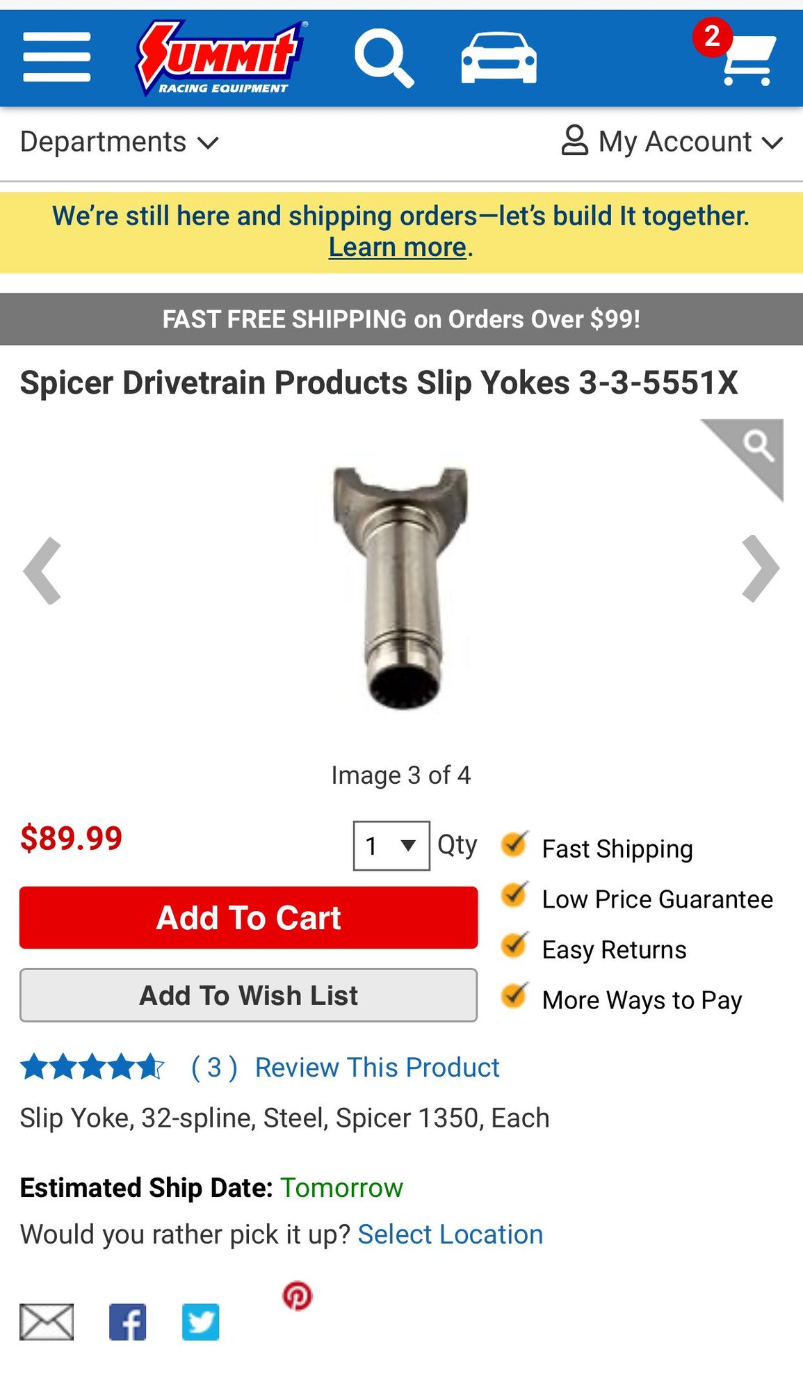

Ok spicer for the win. Ill be ordering one in the morning but now my concern is the image. It appears to be milled on the end. Should I be concerned about that? The eBay/Amazon image doesnt show a milled end nor does it have 208 transfer case in its description.

Call Summit Racing and ask.
On the Summit Racing Web-Site... Normally there is a disclaimer next to product photos, stating that images may not correctly represent the actual product.

http://www.northerndrivetrain.com/pr...3-3-5551X.html

Sorry for any confusion OP. The Spicer 3-3-5551X doesn't have the end of the shaft milled down. Here are the correct images and info direct from Spicer. We will get our images fixed so they match that of Spicer.
