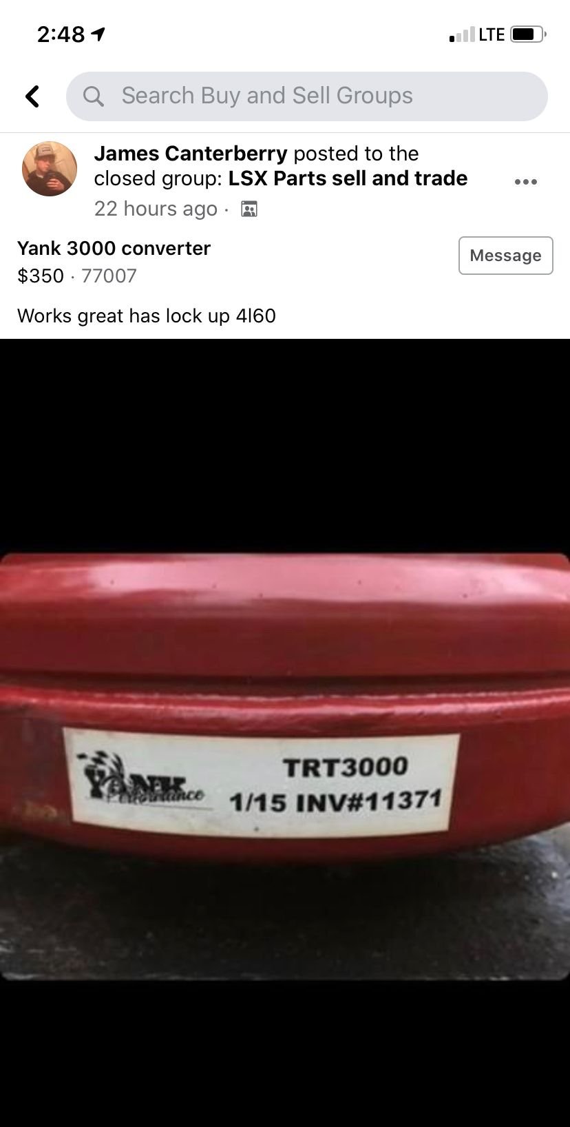

Probably a bit tight for you but just saw this on FB. Pretty good deal... (no affiliation with this guy)
