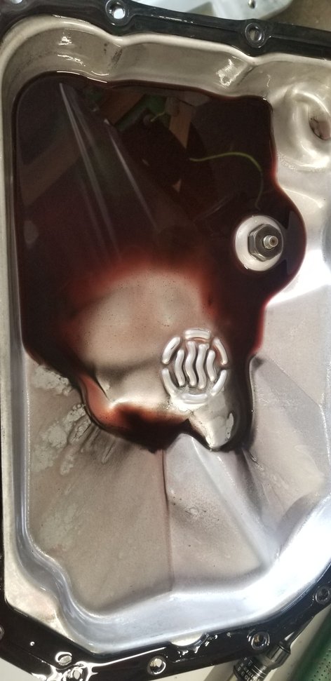

Got gauge installed on it today and I dont think its right....
At idle in park is 110psi or so. No change with raising rpms.
In 1st gear about 30psi
In reverse is hard since its stalls out right away but looks to fall below 60psi. I know thats bad but why I have no idea.
Dropped pan and looks like clutch material in it.
.No idea what the final HP will be in this but everything is built to support 1000+ which will be the goal some day after all the bugs are gone. Any recommendations on who builds these well? Ive seen Jakes but thats about as far as I got. Im in the central ohio area. I doubt I run much over 600hp for the next year or so. Only a weekend warm weather truck. Ive had many people tell me the 4l80 wont hold 1000hp and them others Ive seen do it so I have no clue. Really wanted to keep the OD and not go to th400 but may have too.

Definitely NOT good!
