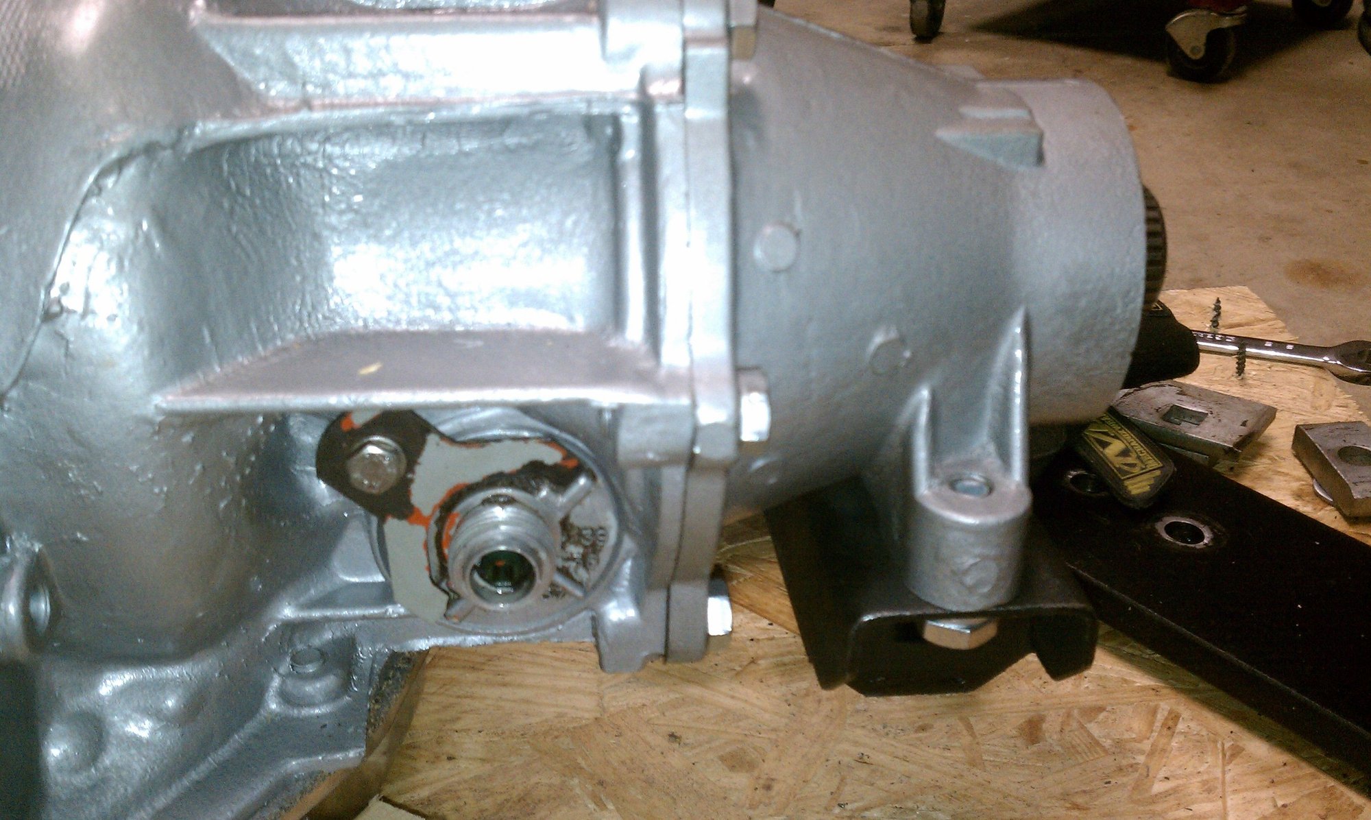

Okay, from what you have said thus far...
I am assuming that you have one of these things:
Sticking out of the rear section of the case, on the Driver's side... looking like this:
Okay, so now you are going to get an adapter... that looks like this:
And install it on to the threads that are sticking out (like in the first 2 photos above).
It will look like this:
This is an adapter for a cable-driven speedometer to an electric speedometer.
You want to buy one of these adapters that is programmable, and can connect to the wiring for your current speedometer.

Yes that’s what mine looks like. you’re the man. The world needs more people like you around. Honestly. You answers all my questions and made it clear as day. Thank you so much. I appreciate the help. Where can I grab one of those?
