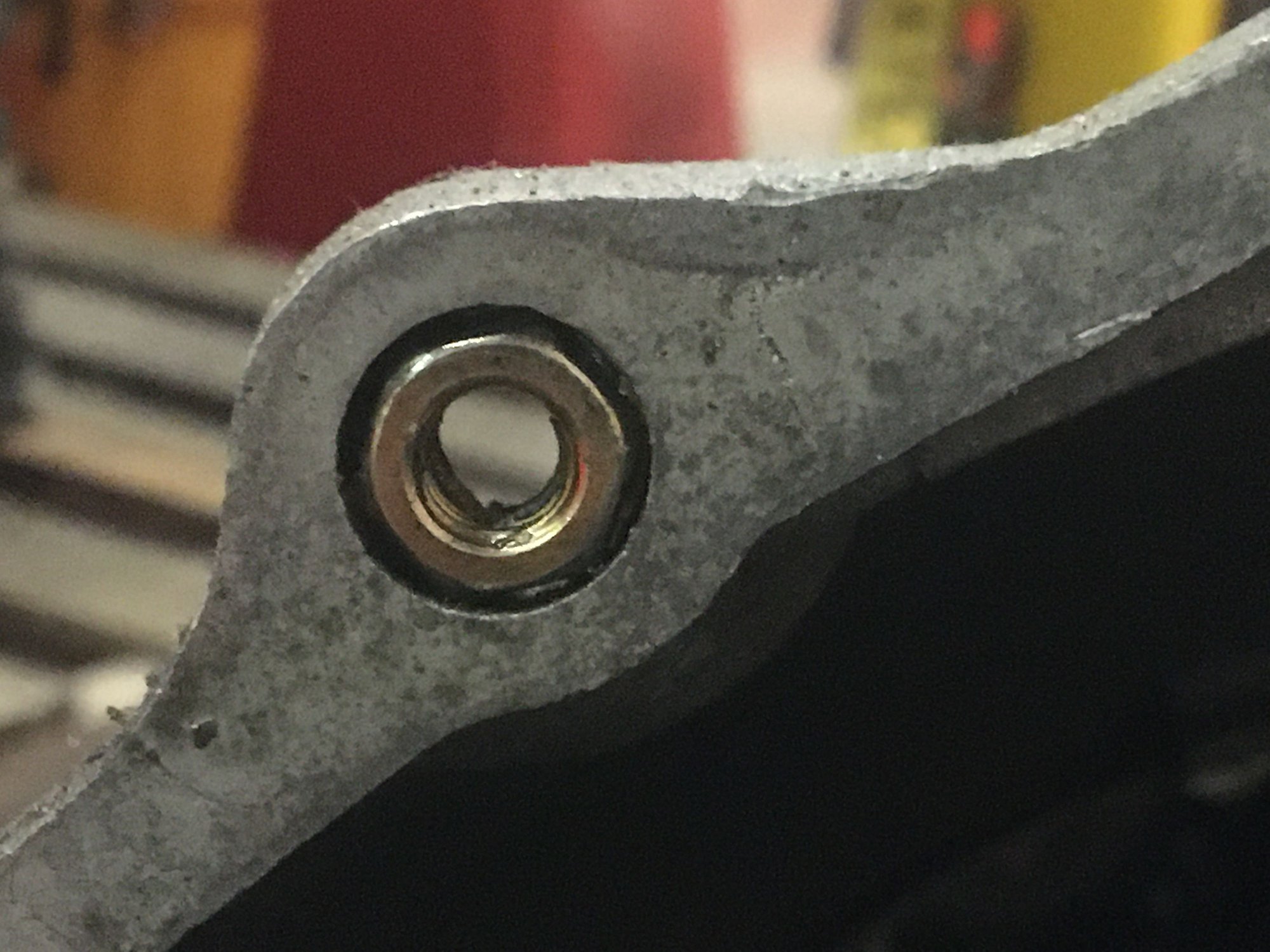

I use a 3/8" nut and press it into the back side of bellhousing. Then use a short bolt for tube.

i read that like 4 times and cant picture it.

The holes are counter bored so the nut won’t go all the way through. This is a 1/2” nut which is loose and needs silicone. 3/8” requires some work but can press in.

Awesome idea!
