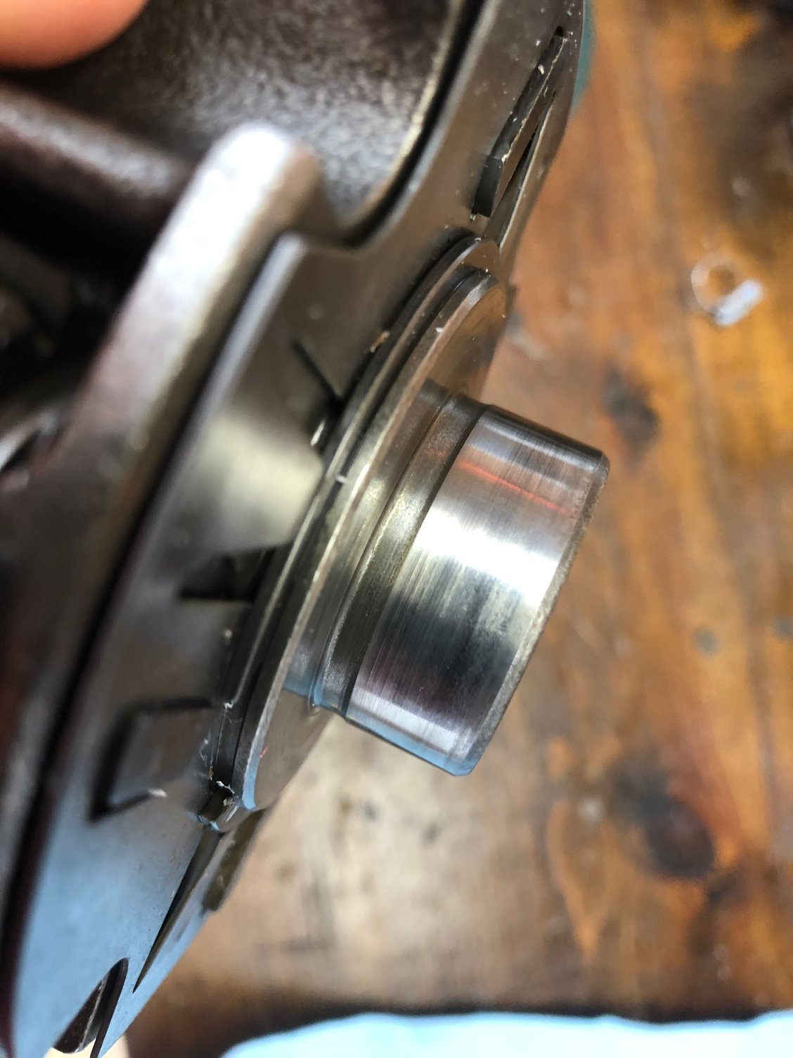

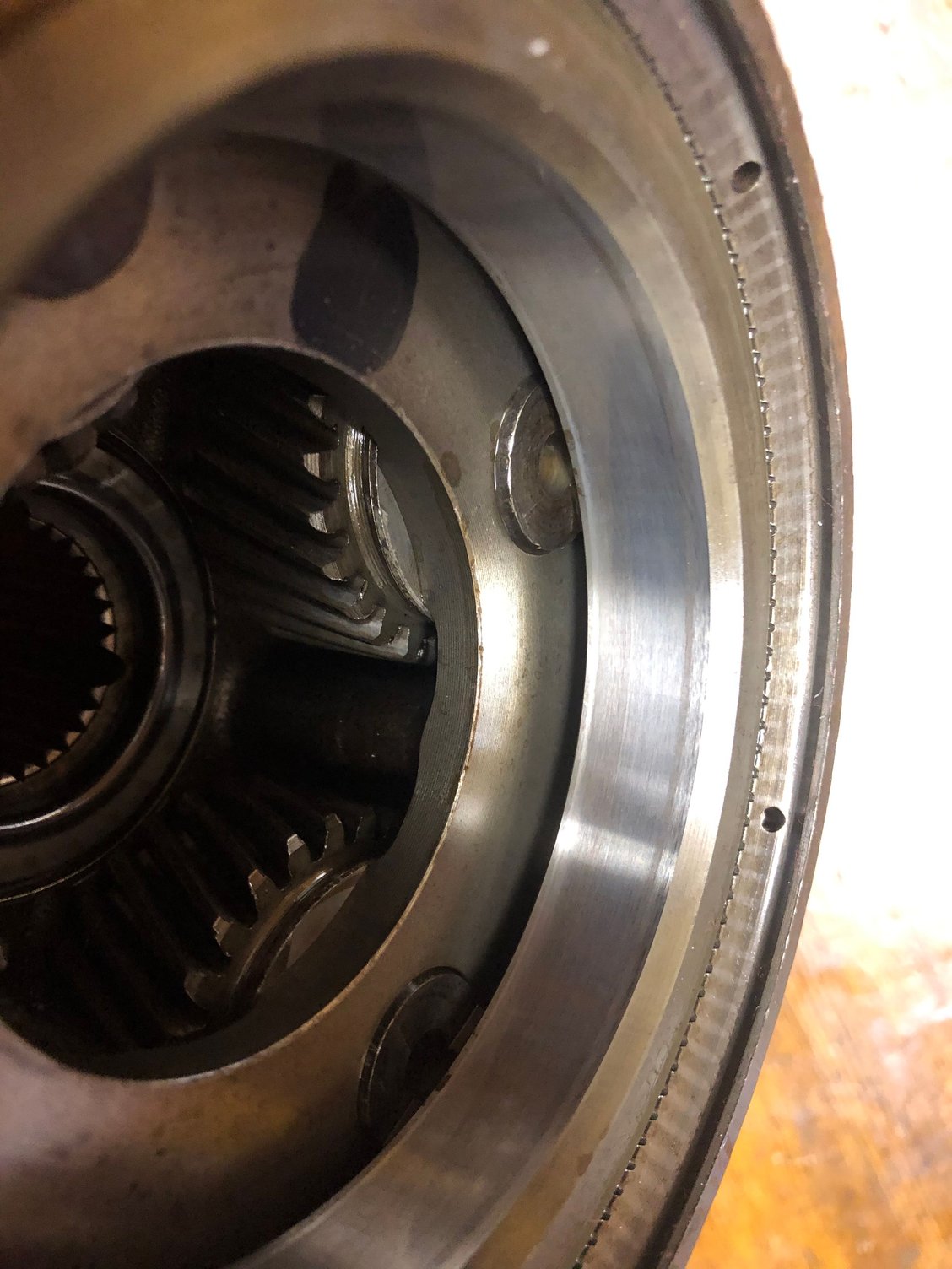

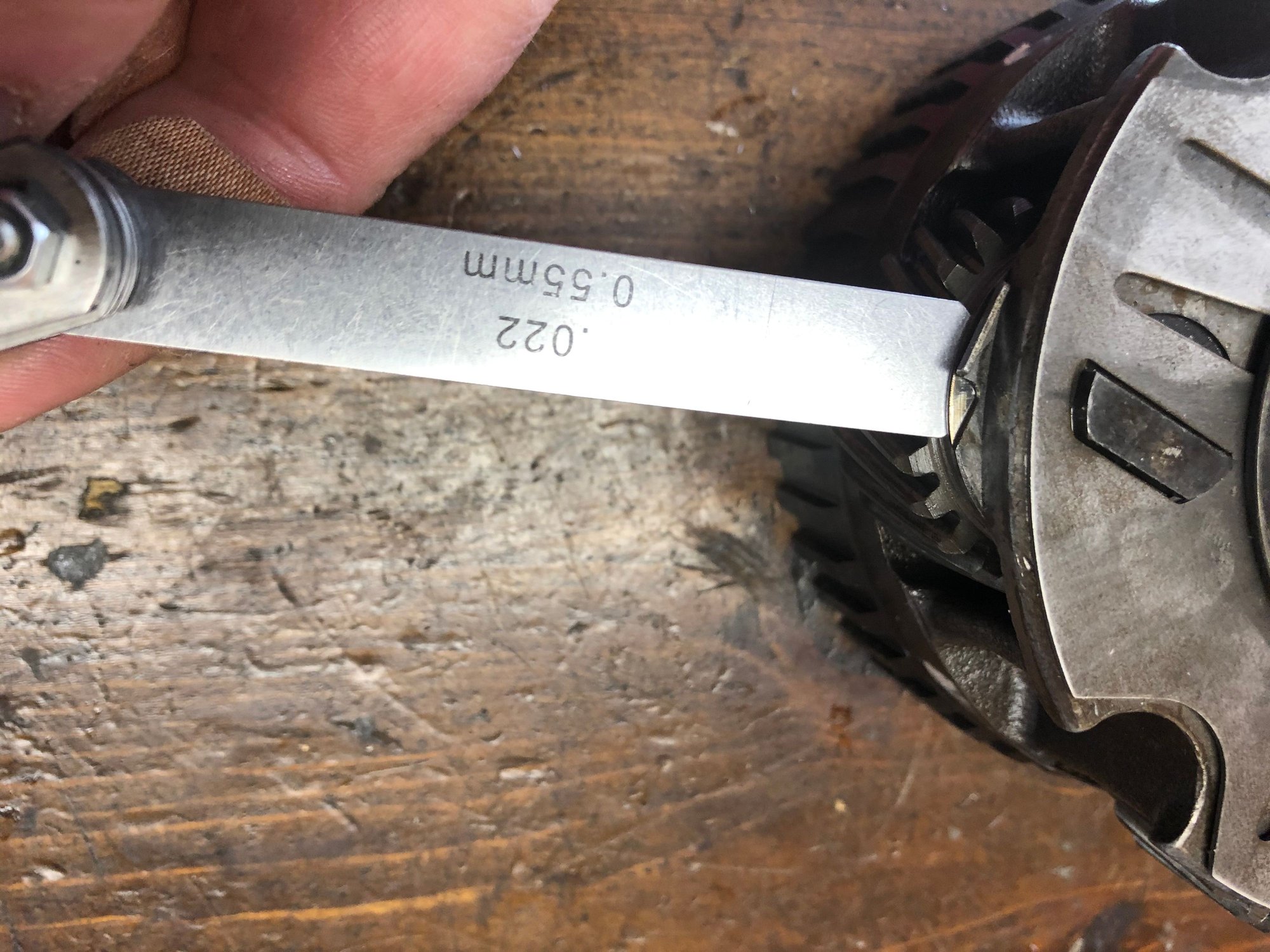

The gear endplay tolerances are .010" to .025" and mine measures .022"
Should I rebuild and replace the washers and needle bearings or send it?
I can't feel any roughness on the race or the bushing journal but they aren't the shiniest. The thrust bearing has no pitting and is smooth.

Yes, there is play when you move them up and down, but not side to side. This much play to be exact
Since there is no side to side rock, it's good to go?
