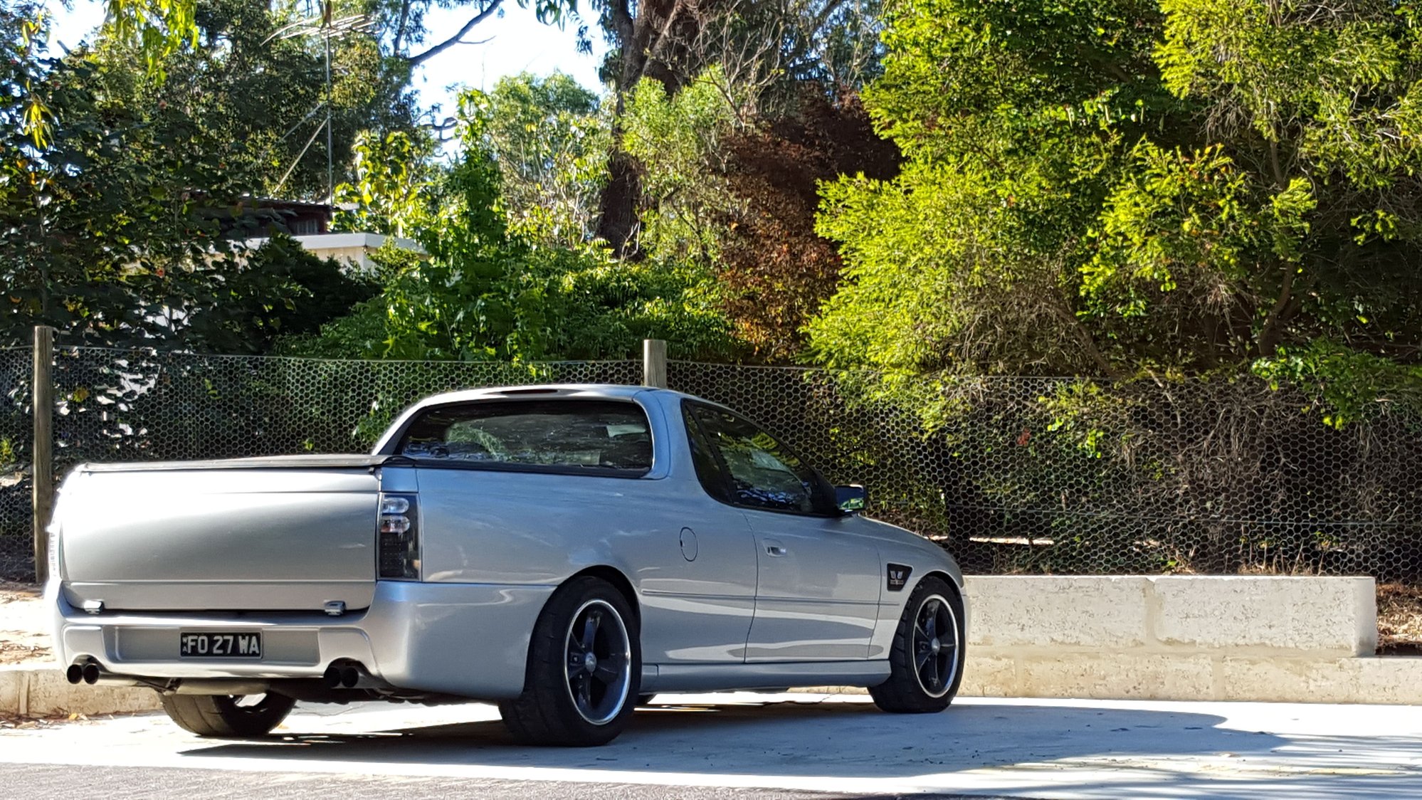

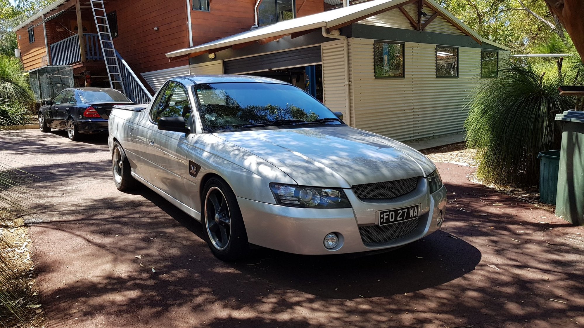

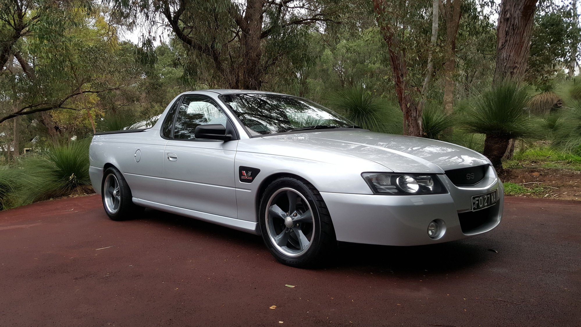

Posts: 27
Originally Posted by FirstYrLS1Z
Got any other pics of the vehicle in post #49, front view and back view ?
Old Oct 5, 2021 | 07:34 AM
  #66
FirstYrLS1Z's Avatar
Active Streak: 30 Days
Posts: 4,216
Likes: 145
From: Euclid,Ohio
Thanks for the pics, beautiful machine !!!
