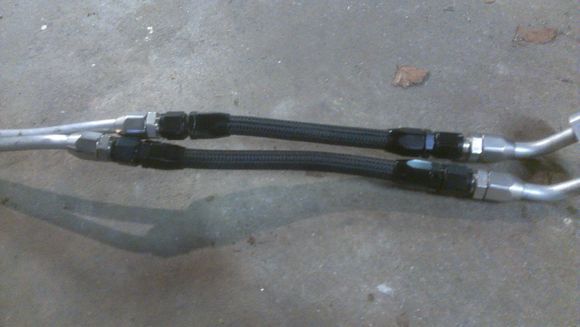

I tend to do this, when I have found the new replacement lines to start leaking at the Crimp locations in a short amount of time.
It makes no sense to me; to keep replacing the lines over and over again.
Here is a set of lines that I made for an Engine Oil Cooler:

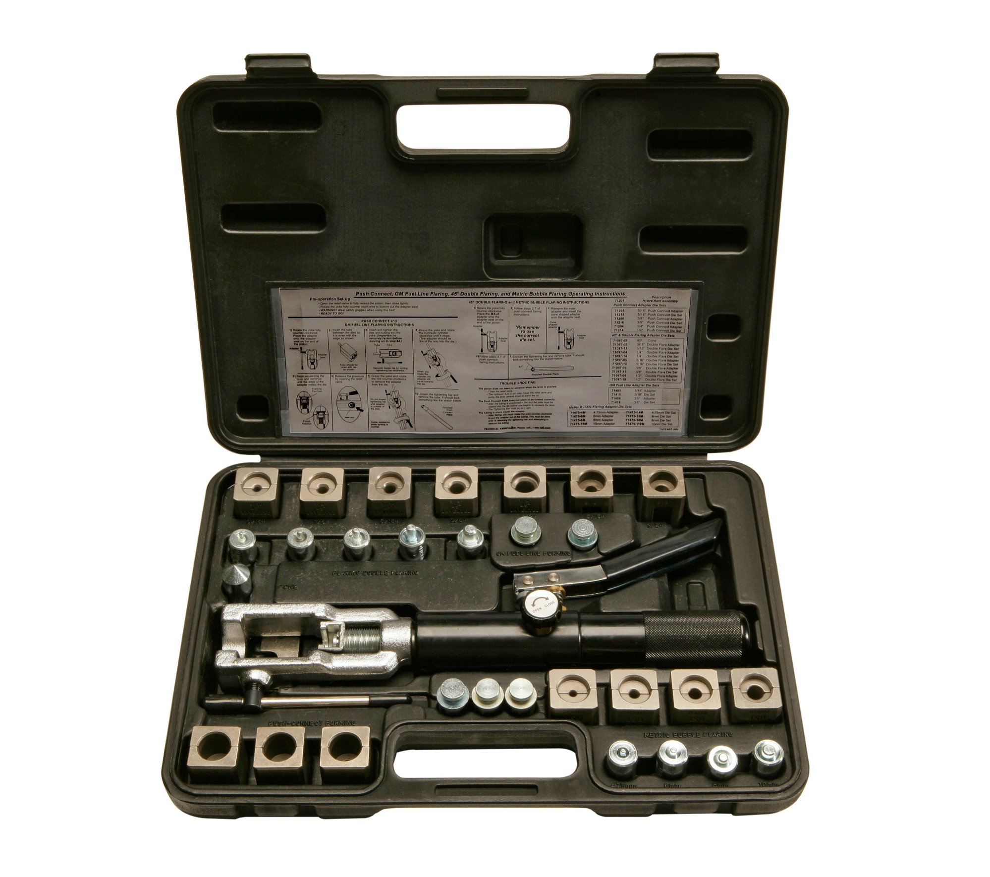

What type of Tubing Bender did you use?
Did you use a Hydraulic Tube Flaring Tool?
The Engineers over at Brake-Systems turned me on to this Kent Moore Tool below:
so what is the P/N on this bad boy tool ? I will see about getting a credit increase on my CC
Old May 21, 2021 | 07:28 AM
The Tool-Set is:
Kent Moore J-45405.
They usually sell in the $600 range... don't pay more!
Also, I see "Knock-Offs" sold for half the price...
However, I do not know if they are Junk or not.

I'm a GM tech and we have the Kent-Moore at work. It is good and handy. But way over priced. There are many similar kits for much cheaper. Just search brake flaring kit. I have my own kits at work and some at home. And honestly, for AN 37* flares, The Summit kit has never failed me. Had it about 20 years and used it thousands of times. Tube nuts are so much better but only if your'e willing to buy the flare tool and use it.
