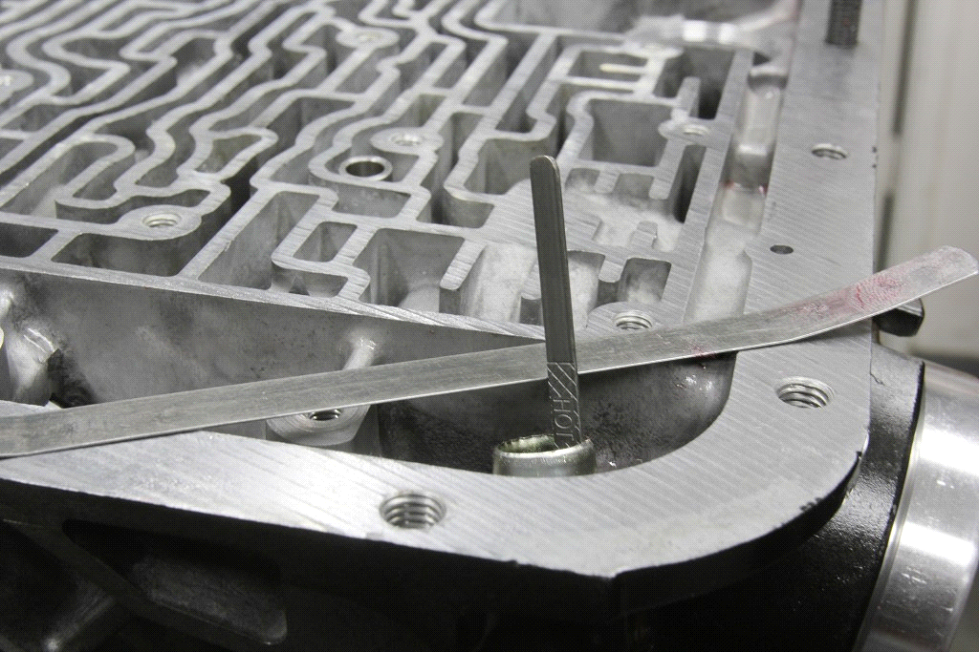

I might as well include the rest of the pertinent information.
First of all; very commonly the Transmission Dip-Stick incorrectly shows the "FULL mark" relative to the "actual FULL mark".
All Automatic-Transmission Dip-Sticks should have the "FULL mark" verified with the Oil-Pan removed.
As in the Image above...
Place a Straight-Edge across the Transmission Oil-Pan Rail.
Next create a mark on the Dip-Stick using a marker, where it is even with the Oil-Pan Rail.
Next remove the Dip-Stick, and measure 0.125" above the First mark.
Next make a Second mark at the 0.125" measurement.
The Second mark is going to represent the "new/ actual FULL mark".

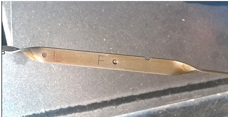

I like to take a very small round File and create a notch in the Dip-Stick at the "new/ actual FULL mark".
The Image above shows a Dip-Stick with a notch added above the "original FULL mark".
The notch is the "new/ actual FULL mark".

The Image below shows a typical Dip-Stick:
The notch that was made into the Dip-Stick, now represents the "HOT FULL mark".
I had talked to Dana about this years ago,he said (IIRC) to put a gasket on the case and then mark the dipstick from the top of the gasket.This will be your "FULL" line. Can you please clarify if your 2nd mark (0.125") is AWAY from the tip of the dipstick or TOWARDS the tip of the dipstick.
