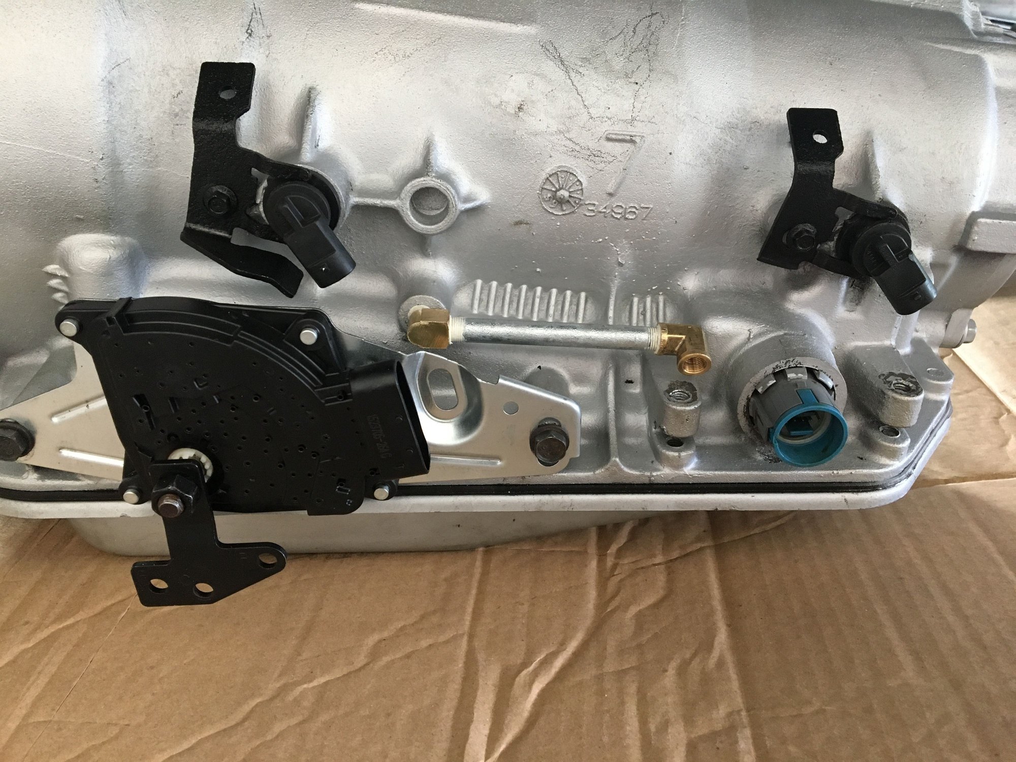

I hope your right and thanks for your help. I removed the linkage from the transmission so I could manually move the shift lever by hand. When doing so, there are detent positions for only P-D....no 1st and 2nd gear.
I was wrong about the year. It is from a 2007 Espress van (see below). It is in my G body 442 and is controlled with an E38 / T42

get a better picture of the rooster comb
either there is an odd comb I havent seen...which is surely possible
or there is something binding up somewhere
