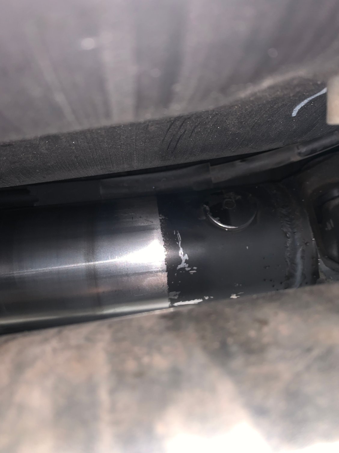

Update: After inspecting the driveline, my e-brake cable has been rubbing the driveshaft, with what seems to be with good amount of force. This should account for the low speed metal rubbing/grinding noise. Not only that, but the driveshaft balance weight also contacts the cable (I can see the paint coming off the corner), which should account for the ticking noise. I plan on going with a 15” wheel conversion soon to get the power to the ground better, so e-brake’s gotta go regardless. I’ll update thread to confirm that noise is gone and was not a transmission issue. Thanks for the help everyone!
Edit: Noise gone, transmission was not culprit
