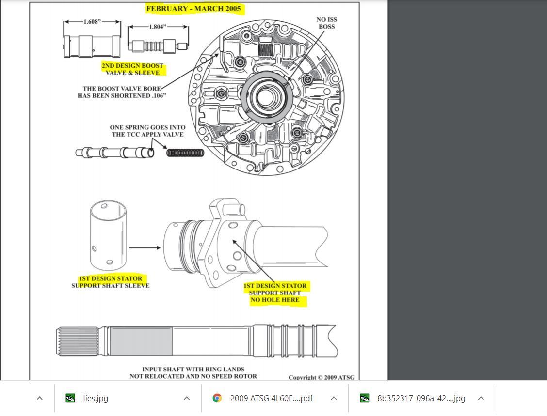

I am having problems matching up a Sonnax 77733-11KA with a non-ISS 7KCD 2007 trans. I figured because of the non-ISS pump, it would use the 11KA. The pump uses the short boost valve and the rubber plug. Evidently (I think) this needs the teflon rings offset .190 towards the drum. Will the holes still fall between the teflon rings, just offset closer instead of centered, or do I need to find an earlier stator/pump with the early ring location AND a 2004 style wedge pump seal for the wedge seal case? Plus the 7-3/8" length! It's too late to exchange or return the 77733-11KA and i'm ready to assemble the trans...I bought a pump from Big Sky but everything's correct except the stator still had the large hole. BY THE WAY I think I need the pump on page 8 figure 2 of the ATSG 2009 Seminar...
Any help would be appreciated.

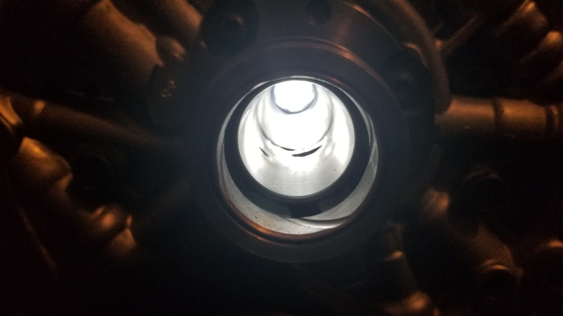

Even the newer pump, I think an HA, Has the 2nd design boost valve, wedge sealing, no ISS plug/no hole drilled, but the stator has the big hole in the journal and sleeve. No way of knowing that from this description:
"GM - 74500HA, 4L65E, PUMP, WITH 2 PIECE CASE, 13 VANE, STATOR CAST # 672, 7 3/8" LONG STATOR TUBE, DOES NOT USE AN OUTER O-RING. THIS PART MAY FIT: CHEVROLET, GMC & BUICK...."

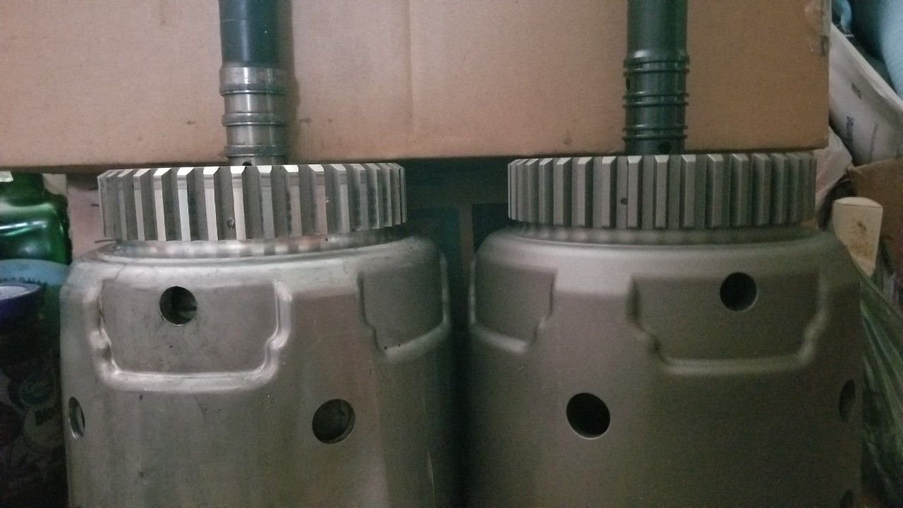

I tried to line up the 2 housings to show how little difference between early & late...look at the placement of the 3rd ring in relation to the lowest hole...
ring placement, late and early...

In blue above sounds like the 2007 pump, but there were no external signs on the replacement HA pump--at least the '07 pump had the rubber plug. The HA pump needed some deep searching...
