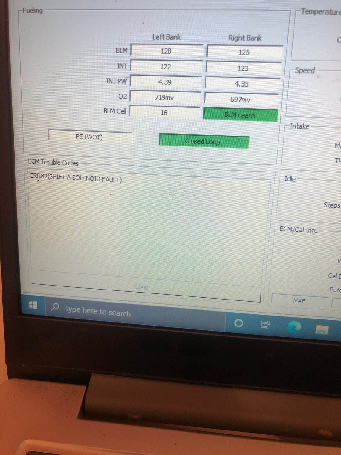

So was able to find codes in ehack. Question I have is my car is 88k on the original fluid.
2 questions:

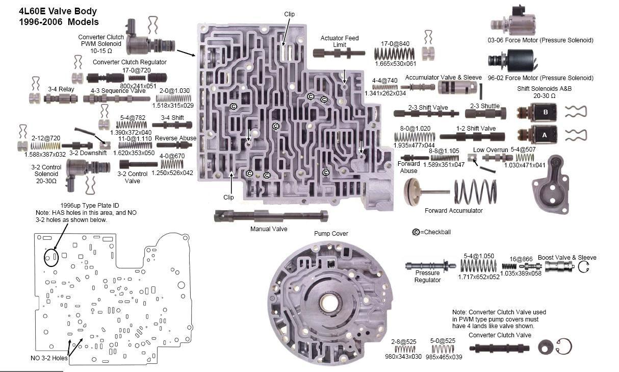

1: which one is solenoid A
and 2: What’s the best way to go about this because I’m a big believer after 50k just leave the fluid alone. Should I reuse old fluid and change filter or just put some new fluid in?!

Change the filter and fluid

Solenoid "A" is positioned outward of the 1-2 Shift Valve-Train...
and can be seen in the Image that 98CayenneT/A kindly Posted for you.
A Filter and Fluid change is most always a good thing to do.
With 50,000 Miles on the clock, I would personally be changing the Filter and Fluid now.
