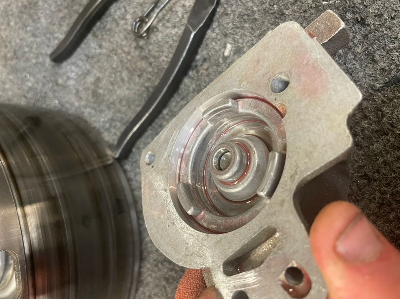

It’s been over a decade since I built a 700r. Guy brought one to me, I almost said no but wth. Well I built it. Has 1st and reverse only. I just pulled it back out. Here’s what I checked:
governor. Not stuck, not worn out, functions fine.
2-4 servo. Has .80-.100 clearance. Not installed incorrectly.
pulled whole trans apart. Saw no issue except for one. It had a stupid transgo shift kit in it and the 1-2 accumulator was stuck at the top of it travel and the piston was almost past the pin. It has a short spring on top and bottom. Piston was cocked sideways and stuck. Probably a huge pressure leak if I had to guess. Could that be the issue?
It was at the top like this, stuck.

I need to add. On the street it would not shift to second. On jackstands it would very easily and slowly go into second and it would downshift to first manually

Looks like a burnt reverse drum in the pic. Any pics of the band? What servo? 4th servo installed in cover correctly?
that’s not the drum from this unit. That’s a drum from a unit brought to me, I put a new drum in it. The servo was installed correctly, I mentioned in post number 1.
clutches, steels and band and drum all look new and unused. I suspect valvebody or the 1-2 accumulator. I just need to know what would happen if the 1-2 accumulator piston was leaking badly.

it would leak accumulator oil into the 2nd gear clutch circuit and make its way through a long convoluted circuit and would eventually exhaust at the 1-2 shift valve

would it still shift? Or just have 1st? I haven’t pulled the valvebody yet to see if I put something in wrong. It happens.

in 1st gear it'll be a big accumulator leak
in 2nd it'll leak oil into the accumulator circuit the other direction
it's the same effect as a cracked piston which is common for the 60e family
don't think it is your no-shift problem but it's not helping anything either.
Check the TV...they are known to stick. If this sat for a while...it may very well be stuck
Check the valve body. Take it apart and check for sticky valves or corrosion etc.
All cast iron vb and steel valves...you see the recipe for stiction there
