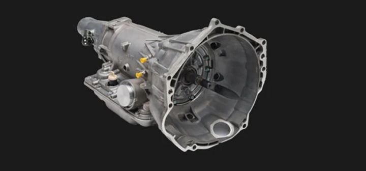

Wink Chevrolet Performance 4L75E-R
Launched at Sema.
Chevy says the 4L75E-R was designed specifically to handle the torque output from the automaker’s new ZZ632 Big Block crate engine, which is factory rated at 1,000 horsepower and 876 pound-feet of torque
Other highlights of the 4L75E-R include a strong six-pinion input carrier and sun gear
https://gmauthority.com/blog/2021/11...n-at-sema/amp/
Take that all you wimpy 4 (or 5) pinion guys !!!
