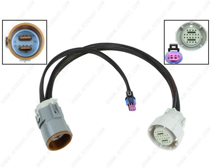

today I saw this Transmission Adapter Harness am not sure if this what I need ?
My car is 2009 with E38 ECM
and transmission T42 TCM
Old Dec 29, 2021 | 02:29 PM

No, you need to swap to any Early PCM for the 4L80E.
