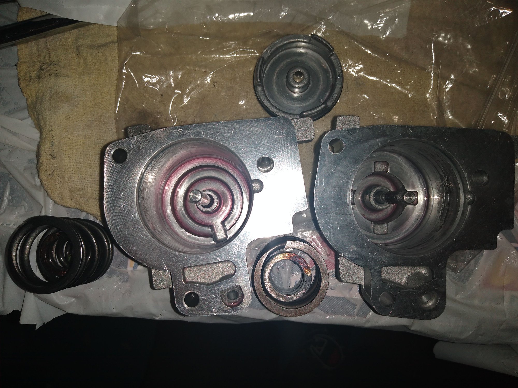

Left (937) right(428) with OE springs next to their housing seems like they could be interchanged?
I Have a 2001 4l60e in a 5.3 l Silverado by the way if this helps anyone's suggestions thanks.

Yes, you can interchange the 937 and 428 1-2 accumulator housings. I don't think it will matter which one you use. The 937 housing will hold the base of the springs better, but the 428 will firm up the shifts with its shorter bore. I would use the Sonnax spring with the stock inner spring. If too firm, you can remove the inner spring. If not firm enough, you can add washers under the springs to get the shift to your liking. Be careful doing this, if you get the shift too hard you may start braking hard parts, like the forward sprag or wear the sun shell and reverse input drum.

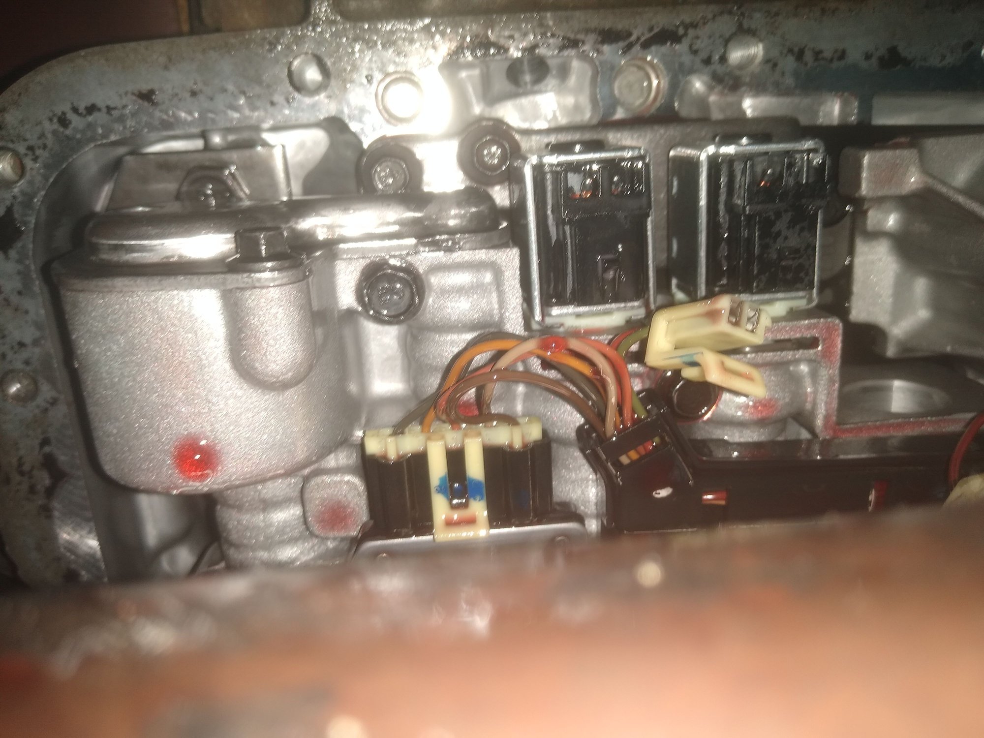

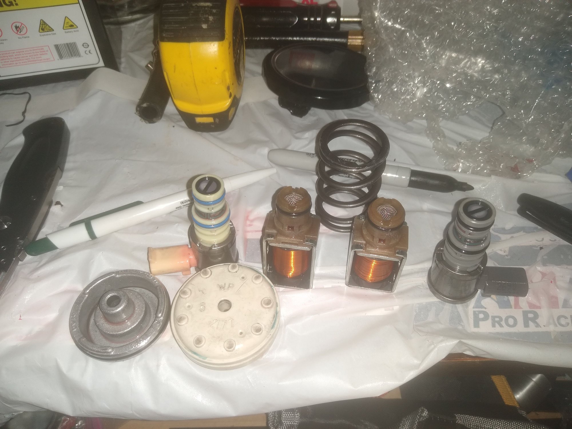

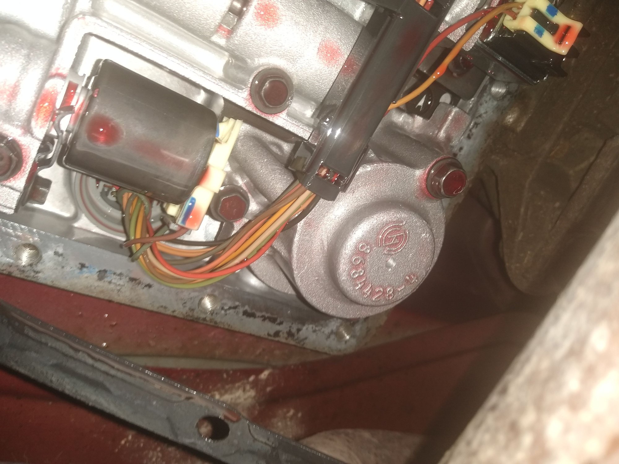

Got em all done and solenoids all besides EPC my forward was aluminum stock thought it would be plastic like my 1-2 but it wasn't put in a new one with new spring anyway I used a transgo aluminum alloy. I ended up having a 428 style housing in my 01 I just used only the outer spring no inner I'll update tomarow after test drive thanks.
