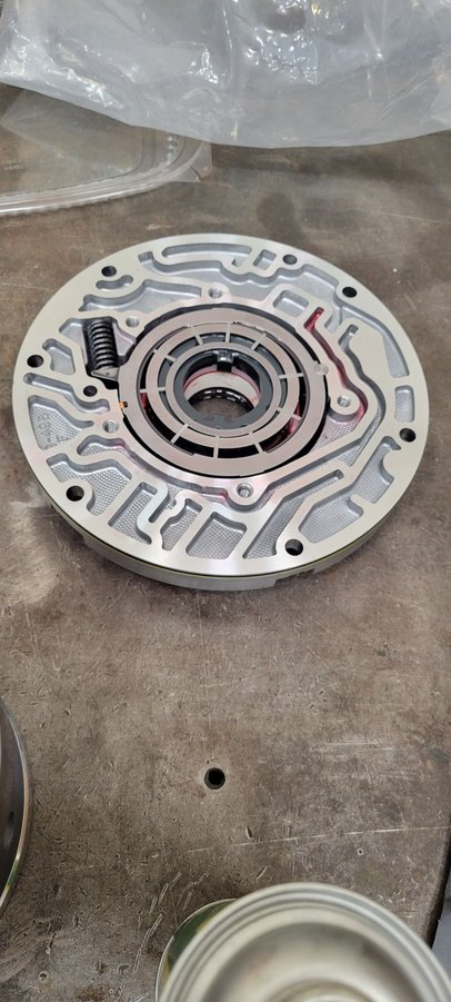

Pump build
- Acdelco 12491420
- Transgo Hardened pump rings 700pkh
- 10 vane pump rotor in 13 vane slide
- Sonnax TCC apply valve 77805E-K
- Sonnax oversized PR valve
- Sonnax O ringed .490 boost valve
Inital Vaccum test results:
TCC apply valve
- Upper 18
- Lower 21
Pressure Regualtor
- 18.5
Boost valve
- 15
Final Vaccum test results:
TCC apply valve
- Upper 23
- Lower 24
Pressure Regualtor
- 24
Boost valve
- 23
I decided to ream the PR valve as I had the reamers and figured it would give me an opportunity to see how much change in vaccum I could see. Im pleased with how it turned out. I also took the opportunity to compare the vaccum tests between the Transgo .500 boost valve and the Sonnax O-ringed boost valve. The trangso resulted in 16hg and the Sonnax was 23. This was partly why I choose the Sonnax valve.
Boost valve question:
- From my understanding of the fluid paths of the boost valve, it seems to me the reduced leakage from the O-ringed sonnax valve, could roughly increase line pressure about the same amount as the .010 bigger TG valve. Sonnax uses O-rings to help reduce leakage, and Transgo uses increased diameter to help over come leaks.
Old Sep 27, 2022 | 03:52 PM
  #40
bbond105's Avatar
Joined: May 2012
Posts: 3,050
Likes: 716
From: Poplarville, MS
I stopped using the Transgo boost valve when I went to install one and the valve was so loose in the sleeve that I just threw it away and have been using the Sonnax o-ringed valve ever since.
