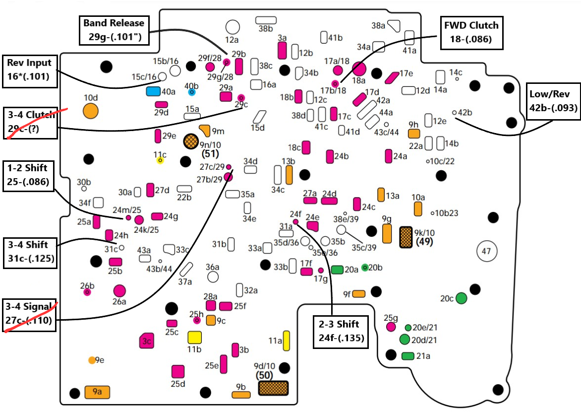

Band release - .101"
Rev input - .101"
1-2 shift - .086"
2-3 shift - .135"
3-4 shift - .125"
Low/reverse - .093"
Forward clutch - .086"
AFL .052 (per sonnax instructions for 77754-09K AFL valve)
Here is what im thinking for my seperator plate sizing. I dont think im going to mess with the 3-4 clutch or signal sizing since I will be leaving the #2 and #4 check ***** active. I ended up reaming a few more valves in the valve body than I had originally thought. I will make another post with what I changed once I have final vacuum test results.
