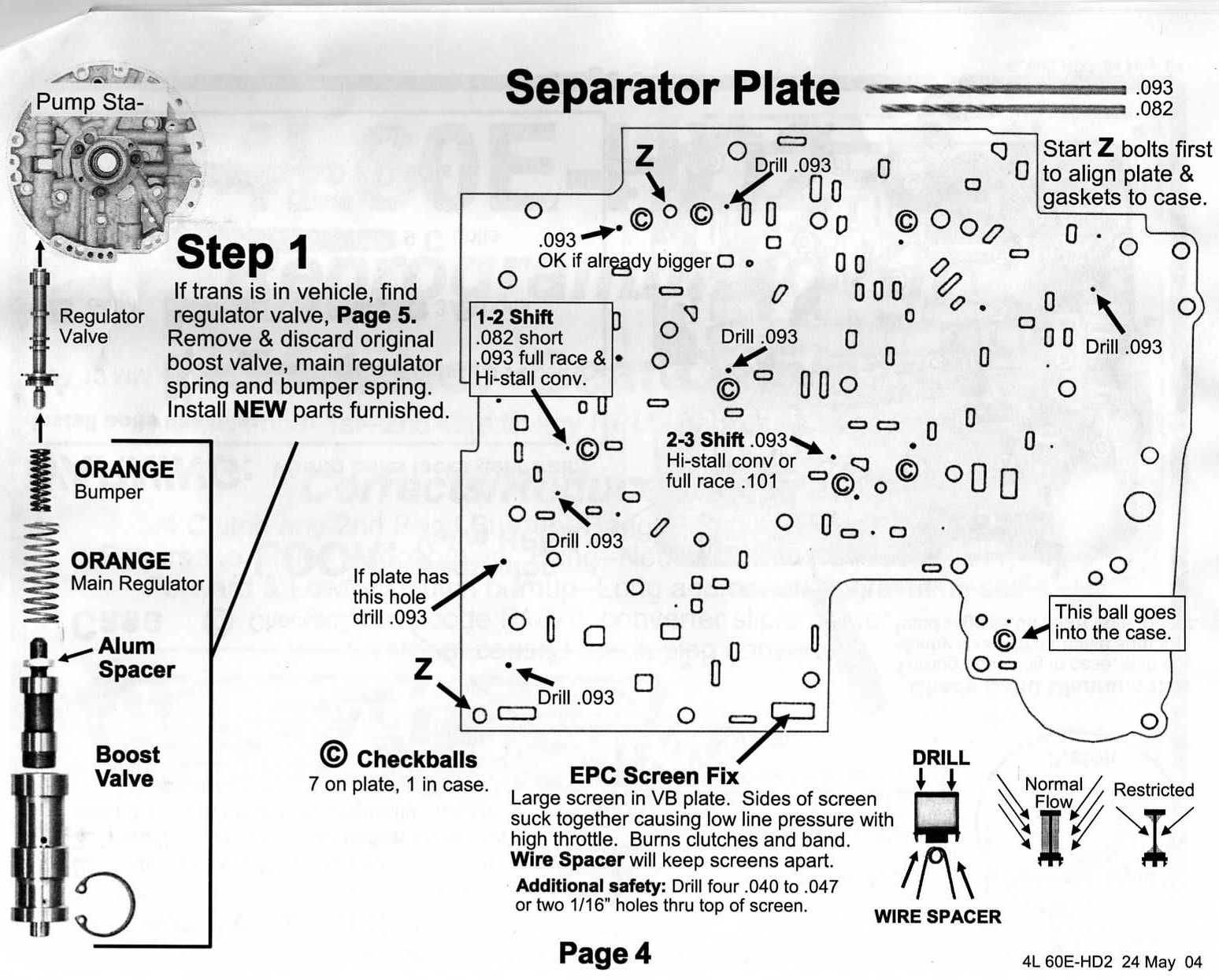

Did you change the separator plate?
2nd Accumulator
housing-->piston-->spring-->separator plate
In this orientation, the stiffer the spring, the firmer the shift
Housing-->spring-->piston-->separator plate
in this orientation, the stiffer the spring, the softer the shift

Was the 2nd gear feed hole in the plate the same size as the old plate?

Could be the spring. Did you actually check the size of the feed holes?

I held one plate on top of the other, and all holes seemed the same size. It was exactly the same as the stock plate. I installed the springs per Sonnax instructions. Placed the metal ***** in the accumulator housing, staked same, springs and then the piston.

you can try shrinking the 1-2 shift hole on the separator plate with an old metal checkball. or ditch the pinless accumulator and go back to stock. like i said earlier, this seems to be a common complaint when using the pinless pistons.
