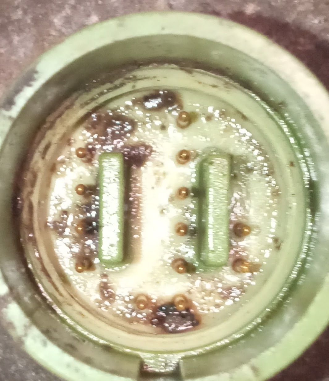

Please Post a Case Connector Image.

Old Mar 10, 2023 | 08:14 AM
Z77CAMARO's Avatar
Joined: Mar 2023
Posts: 6
2007

Unfortunately nothing prior to 2009 is compatible with 2009 and newer Models.
