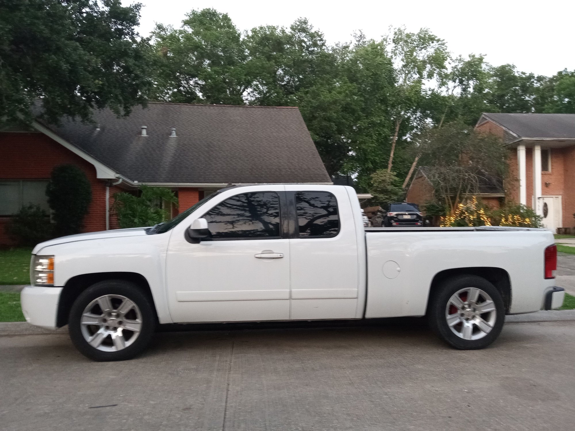

Sorry I should've specified before.
Its an nbs 07 Silverado 1500 with 5.3l and 4l80.
Previous owner built it for drag racing, it's got a 3800 stall converter. He threw in the towel after the trans was rebuilt and the gears starting going.
The NSS problem was that the gear indicator was only lighting up every other gear, as a result the locks didn't unlock in park and I couldn't reset TPMS. The transmission knew what gear it was in but maybe wasn't relaying it to the TCM/ECU whichever it is.
It's got 6 wires coming out of the wider 12 pin harness.
Reverse feel like it engages but barely moves the truck on flat ground. Drive starts out the same way, it's barely moving forward. Doesn't really feel like it's slipping, but idk. If you put it in 3-2-1 it starts in what feels like second. Once you're on the highway drive engages.
