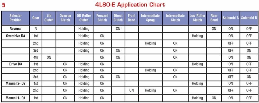

My Guess would be Input sprag not holding . Its nessessary for rev and d4 forward gears. Even if new particulary after market I will only use GM for the late type as we got hold of a few after market ones and they very simply did nothing and we had the syptoms you have on the dyno when in D3 D2 D1 the overun clutch takes over and thats why you can move normally then.

Application chart in this pic as you can see the input sprag in OD must hold in forward d4 and rev

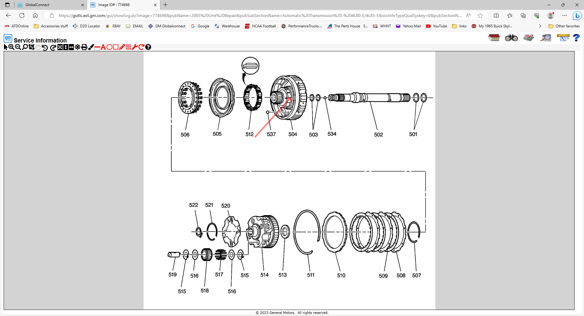

ok. finally got the transmission pulled back out. and it was just something simple. the overdrive clutch roller assembly(512) was not behind the teeth of the overrun clutch housing(504). when you install the overdrive clutch roller assembly, twist the clutch assembly counterclockwise until it stops then install the overdrive carrier assembly. what happend to me was that the rollers were not where they were supposed to be and it let the overdrive carrier assembly(514) spin both ways, and not catch. hope this helps other people that have the same problem as me. it was something so simple, hard to believe it would cause so much problems. ill try to attach a picture.
Good you found it and seems iI was close, Knew it had to be in that area.
